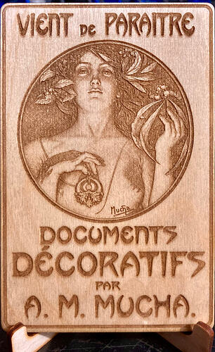

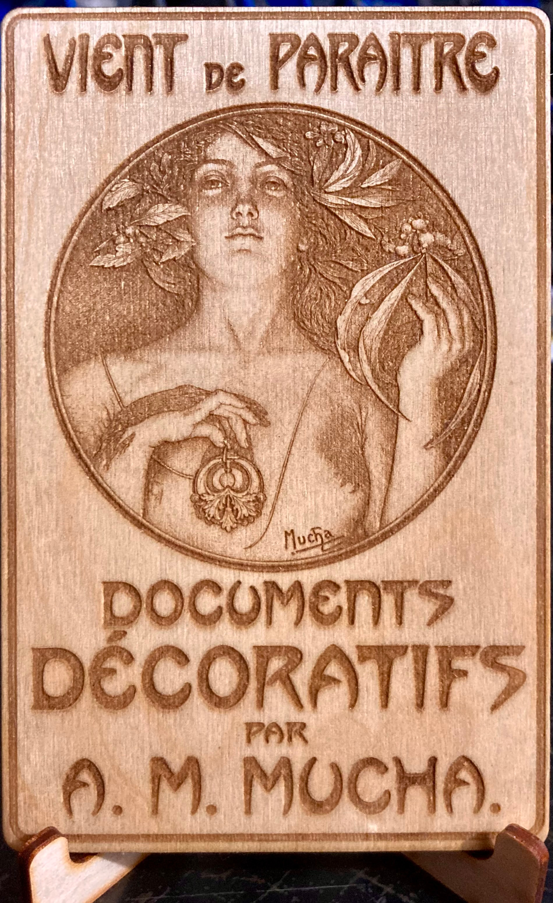

After a rather special day at work I would like to use my CO2 laser for something more enjoyable than acrylic and polycarbonate.
I have some nice pictures with reproductions from Alfons Mucha, who is one of my favorite “Jugendstil / Art Nouveau” artists.
Today I tested if the machine can still make beautiful graphics and it could.
Settings are 200mm/s, 20/8.5% power, 0.08 line spacing and Stucki as image mode.

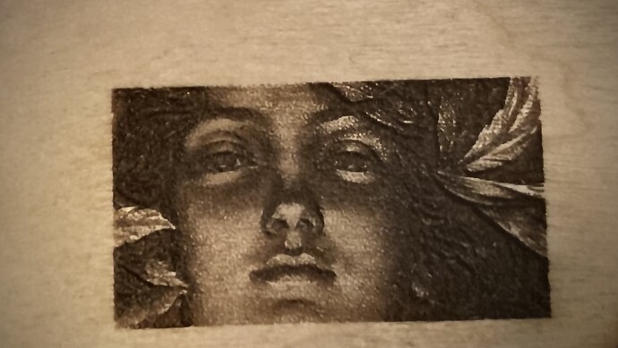

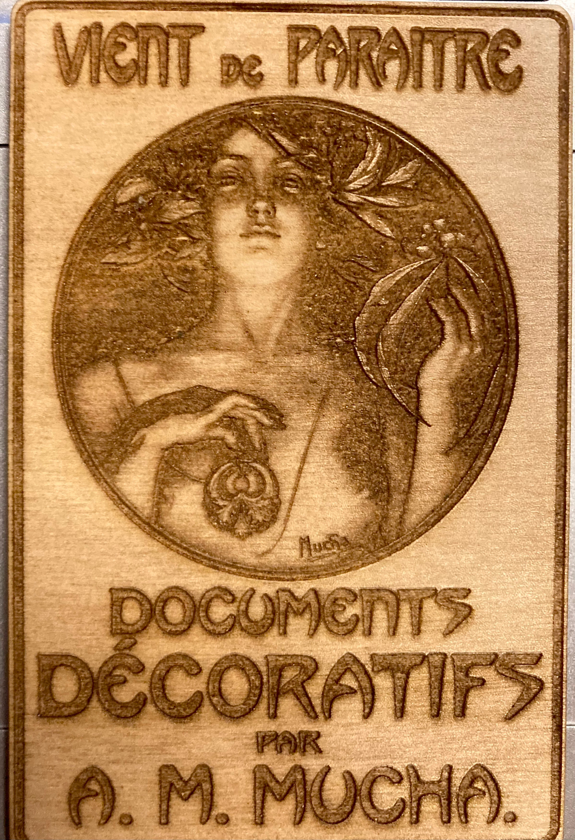

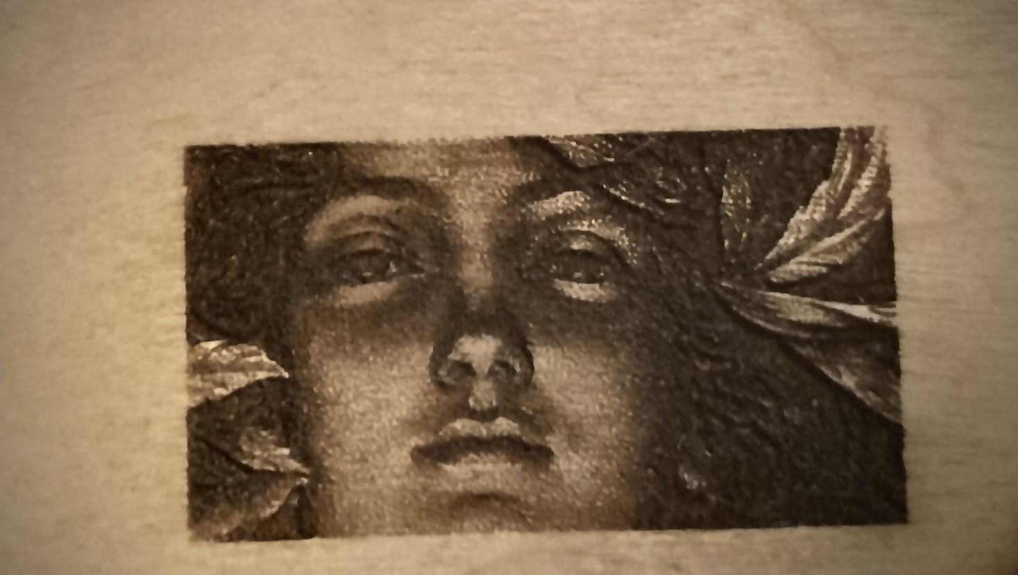

From the test series, each piece of plywood is different. Structure, thickness, moisture content… therefore it is also rare that the image quality is the same.
nb. there is actually a little depth in the images, up to 0.2mm I get. By rotating the image you can feel the relief.
The final result
I can see the relief around the hair, it gives an image a nice new dimension when touched.

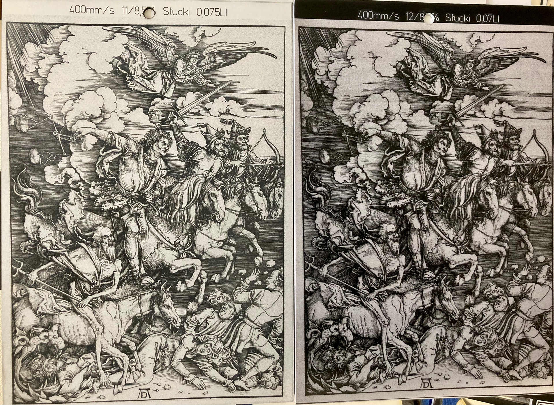

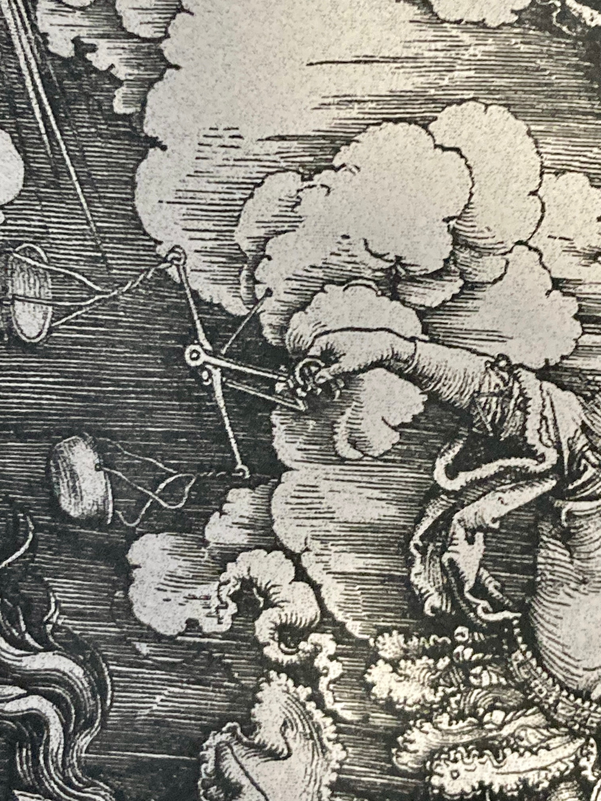

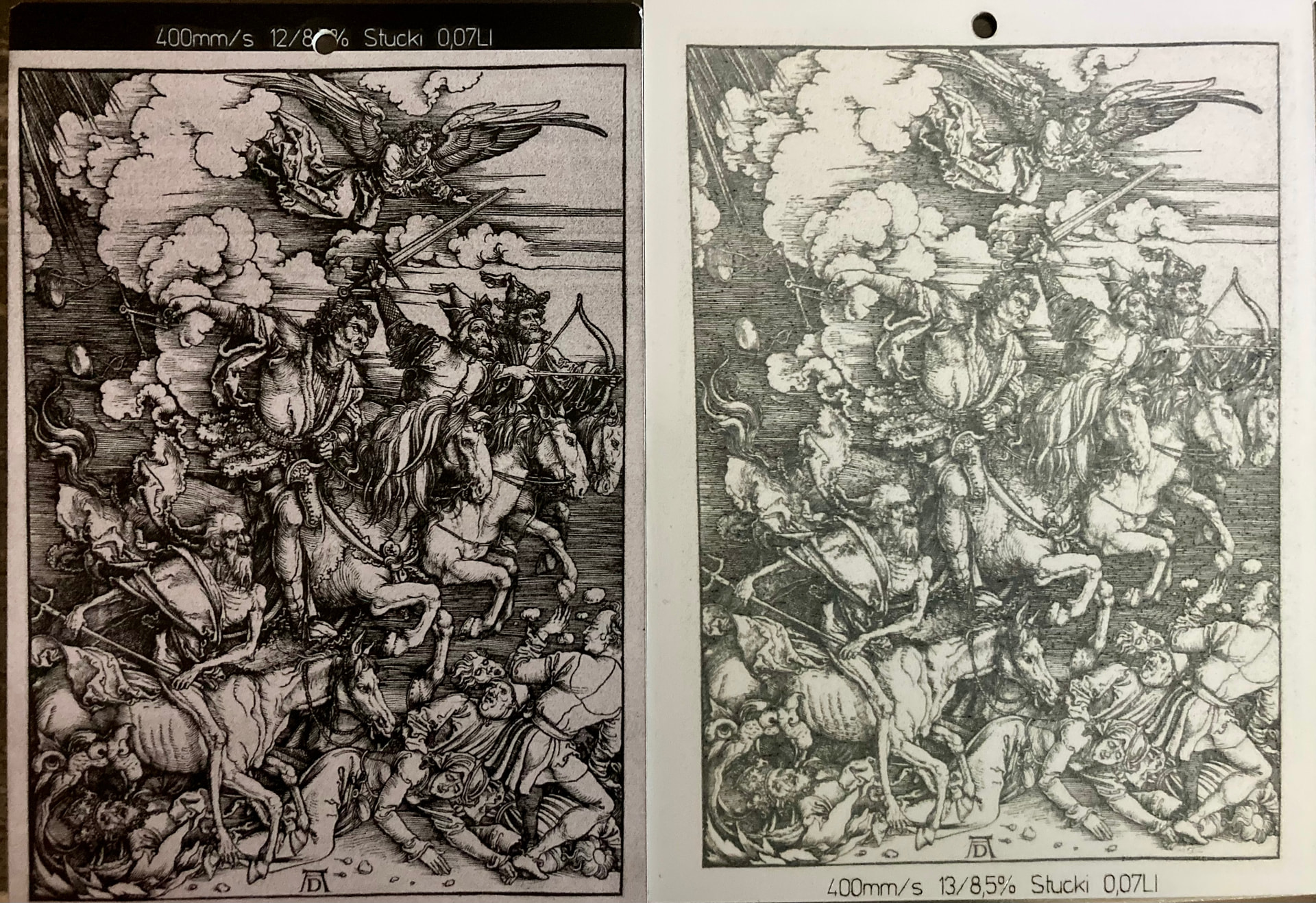

Here is something completely different, it is a copper engraving by Albrecht Dürer, and I thought it would be able to be engraved nicely.
The material is black and white “Sign material” I unfortunately don’t know more about it, it is the thin layer (black or white) that is removed during the process. The values ​​can be read in the pictures.
I couldn’t understand why the “white” material didn’t come out as nice as the black. It turned out to be an “Error 47”.
After removing the thin (PVC?) protective film from the surface, the result came out as nice as the black.

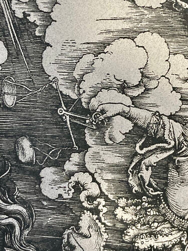

And here’s a little detail, which I lost with the F47 error in the first attempt

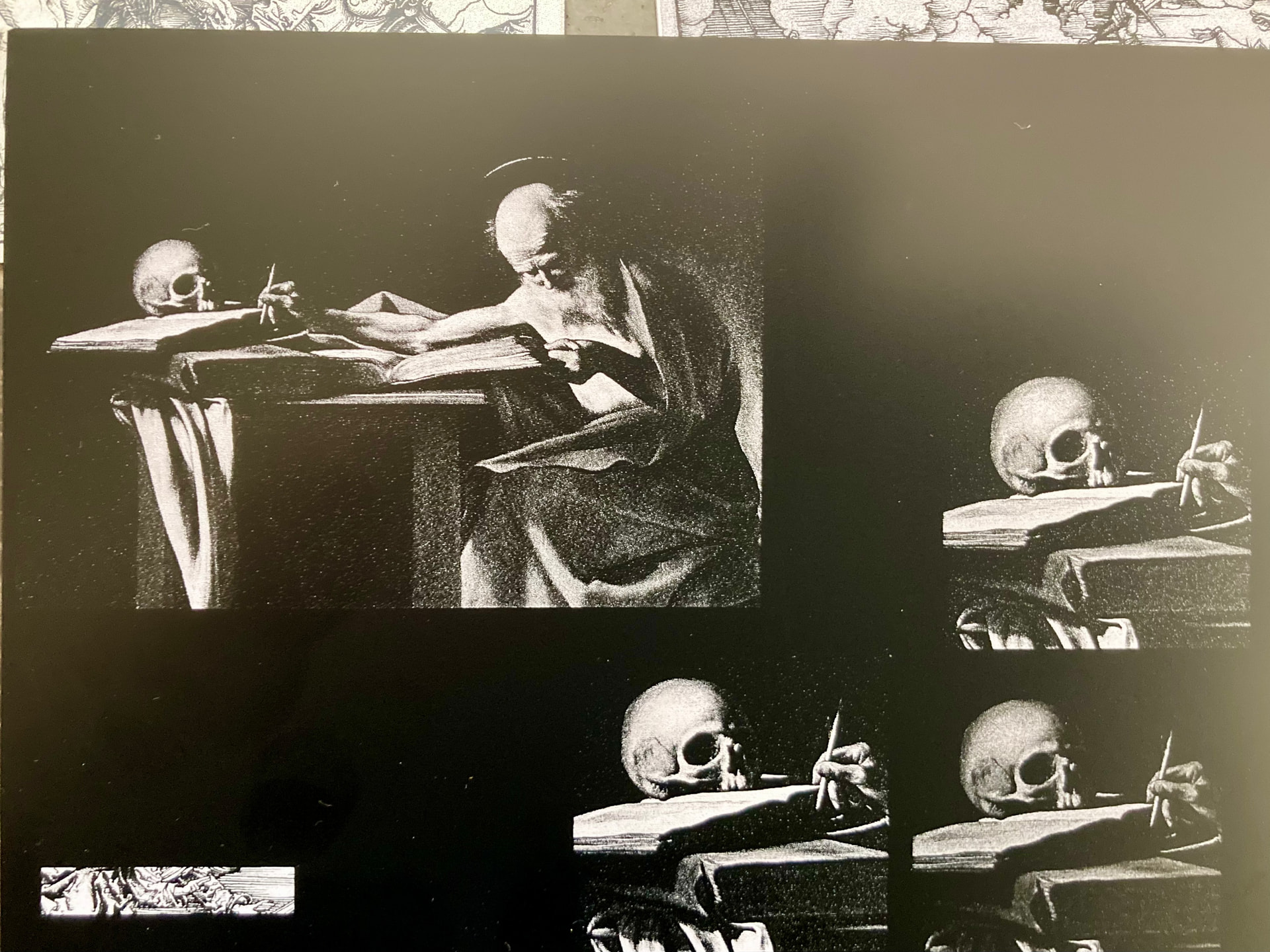

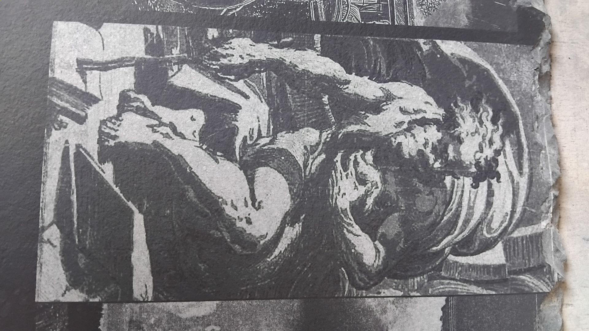

I tried, but due to the special contrasts Caravaggio uses, it is very difficult to reproduce properly.
In the 3 lower tests there is a difference of 0.5% power. (60Watt CO2)
Not bad from my view but you are looking at the actual rendition, I guess Caravaggio had colour to play with.
Which dither did you use.
I used Stucki, 300 mm/s 11/8.5% power.
I have the problem that the settings from tests cannot be used directly for the actual “production”, if the size is significantly smaller in the tests, the power settings must be adjusted. This could be avoided by using a much lower speed (approx. 100-150mm/s) but then it takes even longer…

P.S. The Albrecht Dürer images are 150x100mm in size.
