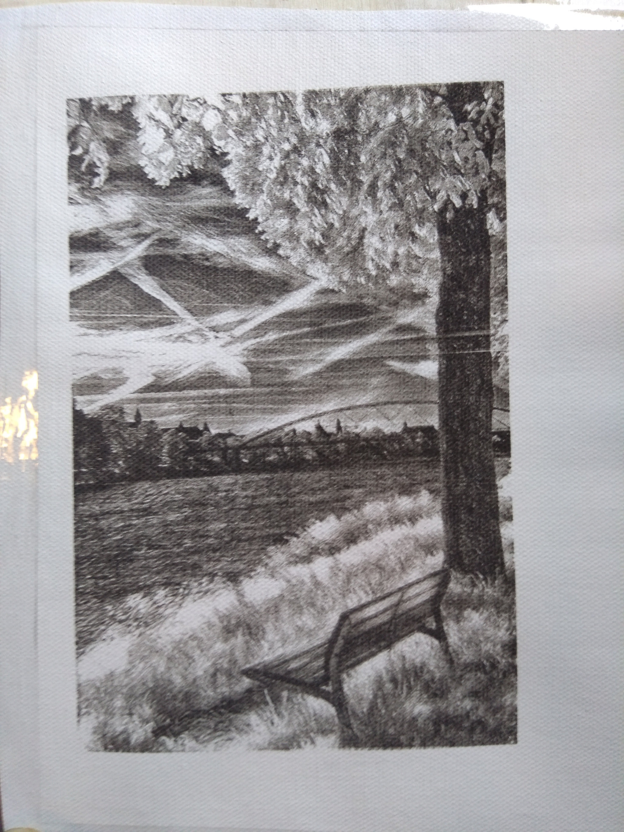

Itâs because you used passthrough, I suspect - that means âdo not resize, adjust, or touch - just threshold and send directly to the laserâ. It is intended for images that were dithered externally using things like One-Touch, PhotoGrav, etc.
If you are sending a normal photo through LightBurn, what you did last is the best option. You can select the photo, right-click, choose âShow Propertiesâ and adjust Gamma (mid-tone curve), Brightness, and Contrast, as well as edge enhancement options there.
I removed the passthrough and from interface perspective it looked the same on the settings. Something was not taking the correct values I guess.
Pass through ignores the settings. Thatâs why they all get disabled, because they are not used.
That I get it, but even disabling it it was not working. Like in UI been disabled but not in reality. Will try to replicate later to see if I find what can be wrong
What a coincidence, I am writing a blog about how to dial in the engraving. It will be published within a day on awesome dot tech. I see you try to run the test pattern to determine the dot size which is a great starting point. Try to engrave the pattern at various focal points to find the best dot size. (Threshold or Grayscale setting at Speed 50mm/sec at 15-20% power)
Within k40 and a good quality lens you get about 250 to 350 dpi unless your picture is lower resolution.
Try Dither, at 127 DPI, at 70mm/sec with 14% power. Try another photo incase the image is just too low in resolution. Make sure over scanning is enabled to avoid jarred edges. Make sure that you have a sharp focus otherwise you wonât get it right. Let us know how it went!
