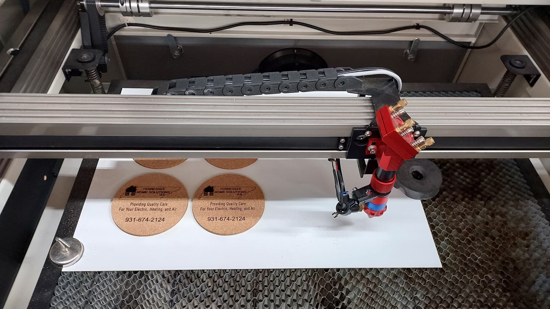

I’m marking up 4 coasters at a time in a jig. When the job is done, the gantry moves to the middle of the bed, blocking my way to snatch them up, and replace them with 4 news ones.
What do I need to do, make the gantry move up some, instead of stopping in the middle. FYI, the last one marked is the top left. If the gantry would just stop there, I’d be happy with that.

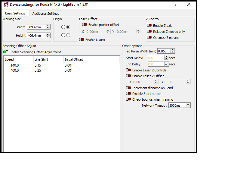

You can set the finish position (return to finish position) within the device settings.
Thanks MooseUK
I’ll look it over, and see where I can tell it top left -vs- in the middle of the table. I don’t have a return to finish setting to tick. v 1.3.01
I found this, but it doesn’t apply. My move window doesn’t look this in the link
https://docs.lightburnsoftware.com/CoordinatesOrigin.html#finish-position

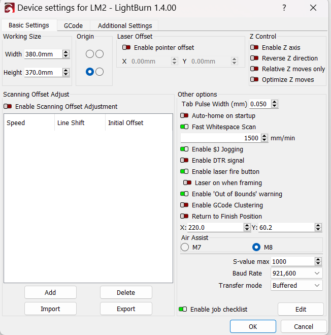

In device setting there is an option set where to move on job finish, i set mine to 400 400 to move to back left.
Not sure that it’s there…
Maybe I have can’t see the forest for the tree’s syndrome, this a.m.

Apologies Phillip, I didn’t realise that option wasn’t available for Ruida controllers
The Ruida has this in it’s machine settings… called return or something…
When you select it, you can change it via the drop down menu…

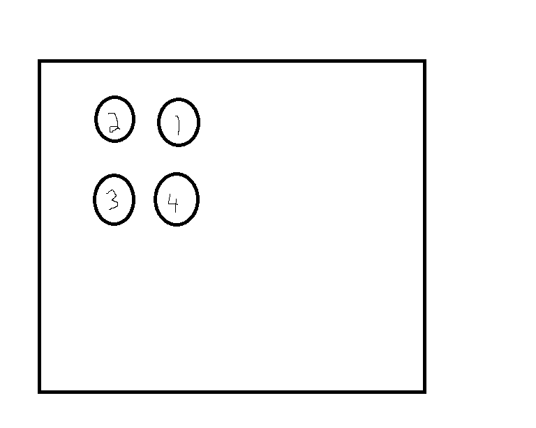

Just to show you where it stops, and fill sequence on them. There is two layers. 1 fill and 1 line. It puts the line in position 2, which is the last one in the line layer. Then the head moves to the middle of the gantry. I’m around 3/4 done with the order, but it would be nice going forward on how to make it go where you want when a job is done for large production work.
