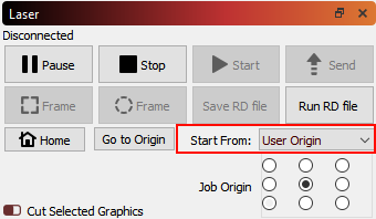

You need to switch the option (start from mode) in laser window before exporting. The positioning method is definitely saved into the gcode file, I used both options already.
Which machine do you swith?
I cannot fint this button
Thank, after it i click on save as gcode.
I tried each from this, but gcode is each time incremental.

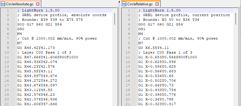

See here. Check my selected options and the green square showing the origin:
Absolute Coordinates:
Relative Coordinates:
GCode-Output:

Note that even setting “Absolute Coords” does not guarantee exclusive use of absolute positions. Some things like images will always use relative moves. It, however, does use absolute coords as the starting point for those relative moves.

Here you show that you are using absolute coordinates, not relative ones. .
The G91 is weird then. Did you add some start or end gcode in device settings?
No setting in LightBurn that I’m aware of will force exclusive use of G90. G91 is used whenever it’s more efficient to do so.
There may be certain conditions to avoid that will get you this. For example, I suspect that if you don’t use Fill or Image that you will get G90 moves only.
I don’t understand what you mean by this. All g-code device types should create true g-code.
This is actually normal.
Try generating g-code from this file.
g91.lbrn2 (7.3 KB)
Ah, you’re right, he uses fill mode there, I only used line mode. That’s the optimization step you meant before. Didn’t look closely at the workspace.
