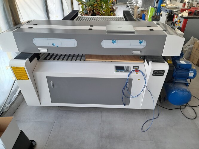

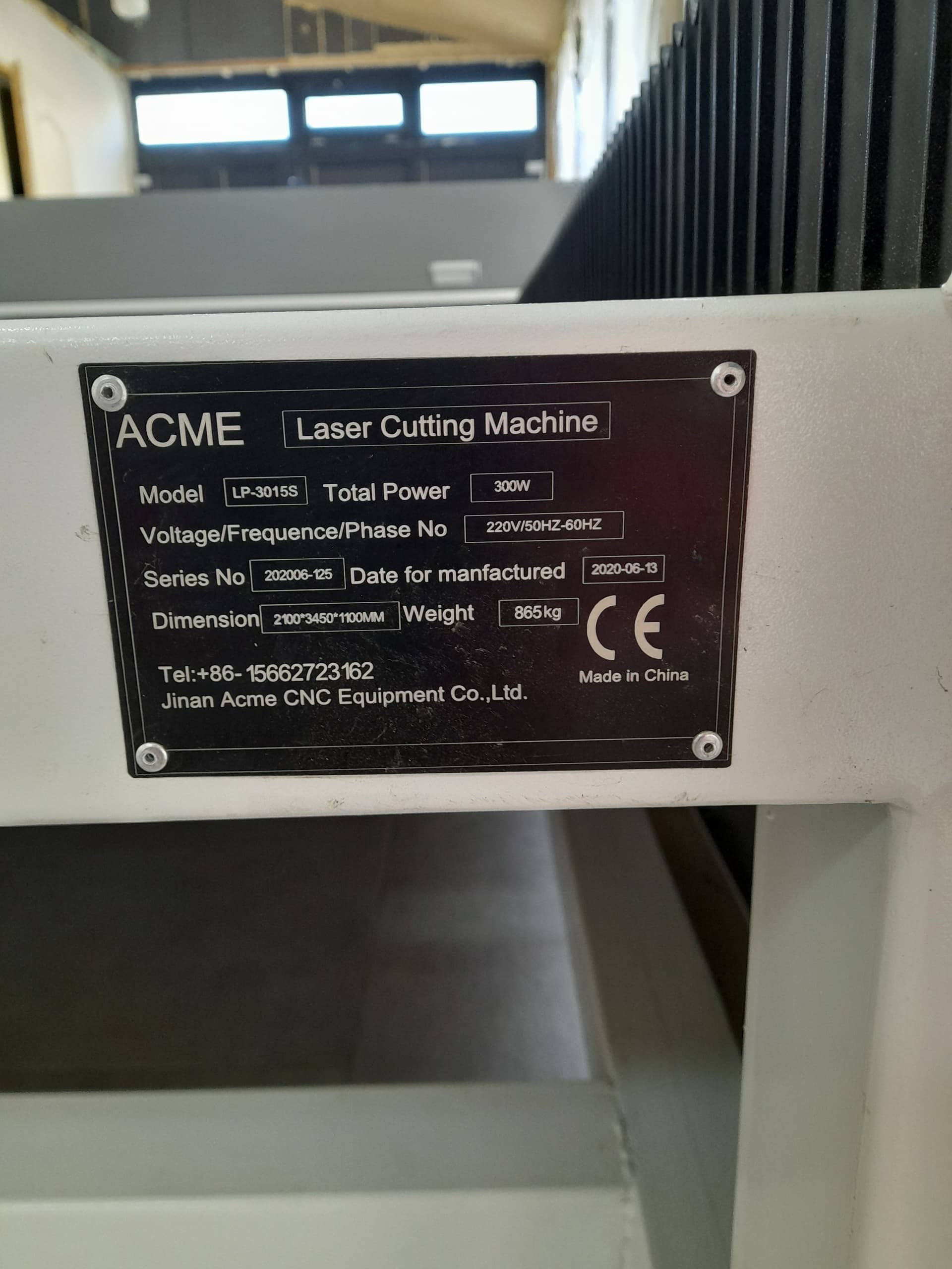

Does anyone own such a machine? ACME Laser Cutting Machine LP-3015S
I can’t connect it to my laptop.Error:Transfer Failed-LightBurn1.4.05 The was a problem sending data to the laser.The machine may be busy or paused.

With this machine, I don’t know if it is a grbl based machine, but I doubt it.
I don’t know if Lightburn will be able to drive it.
I saw no indication here as to what control board it has or the software it’s capable of running. From the look and that it cuts metal, I kind of doubt it’s a grbl machine.
Can you look in the electronics bay and tell us (or show us) what controller is present.

The normal grbl can’t really control most fiber sources. The power input control for most of the sources I’ve seen is an 8 bit word… Not pwm, so I doubt it’s grbl. But I’m willing to be educated.
Many people are new at this and don’t know what to enter for some of these questions for their profile… So it’s understandable they get confused or mislead.
I think the cost and type of this machine is more than likely a proprietary software… at bare minimum it’s built in and appears to be Chinese.

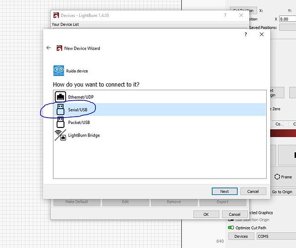

Looks like a 6445g and Lightburn should connect.
Are you using usb or Ethernet?
Did you have any trouble setting up the device type when you created the profile for that machine?
Is this a trail version of Lightburn?
It works.With Ruida.
Select:Devices; Your Device List; Create Manually; Ruida; Serial USB.
