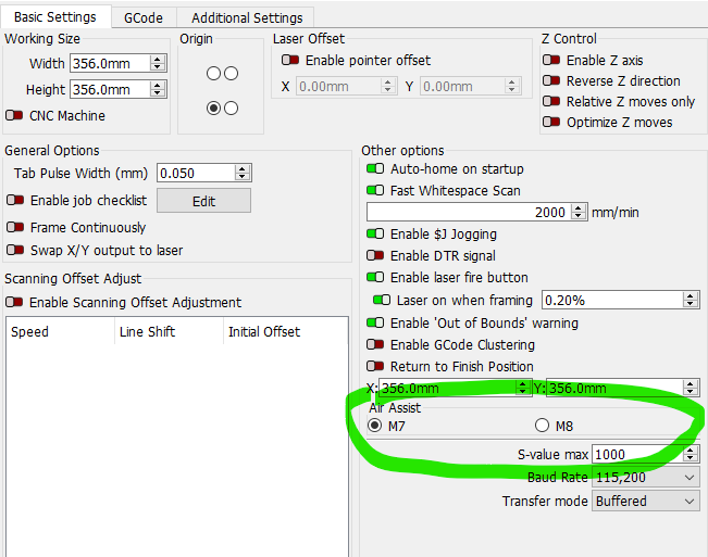

Have a new ACMER P2 20W and Running on LightBurn 1.7.04 directly connected to laser cutter on com port.
When ACMER P2 20W is switched on the air pump works then switches off as test
When Running function from PC to ACMER P2 20W - on LighBurn cuts/layers indicates that air in on - But the air does not come on the ACMER P2 20W?
ACMER P2 20W is new out of the box as well as software installation
Troubleshooting - are there tweaks or other configurations i have to enable in the software
Check device settings in LightBurn, I think that for Acmer M7 should be selected for air assist and not M8

I much appreciate your response, i did check the G Code and M8 was inserted before and after runs , but as you stipulate maybe M8 non-functional
I will be trying this toggle later on today, fortunately i have a large noisy compressor which i used yesterday , but when the compressor started it triggered a fault on the laser cutter , Appreciate the feedback, have a good one.
