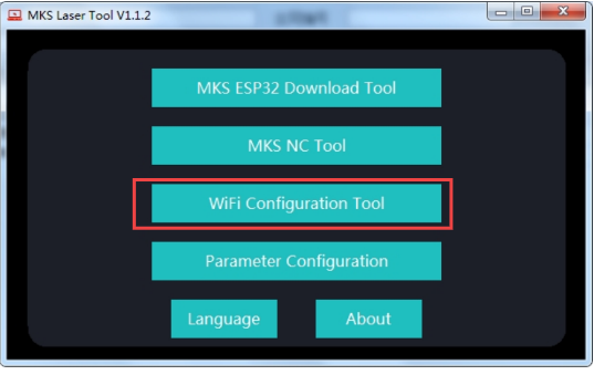

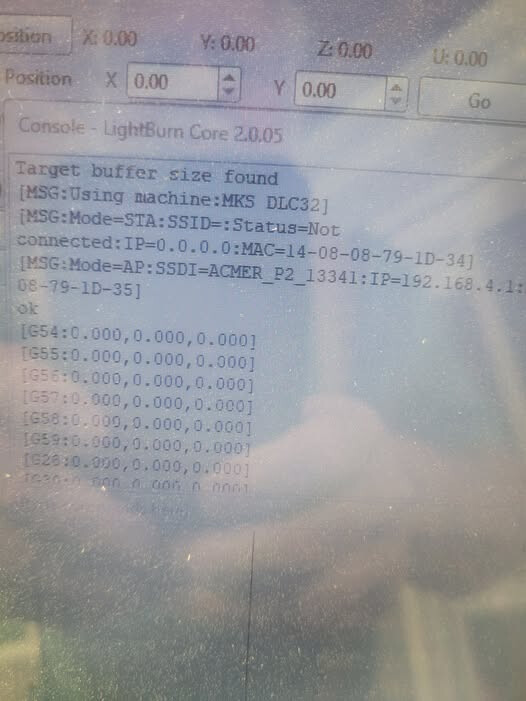

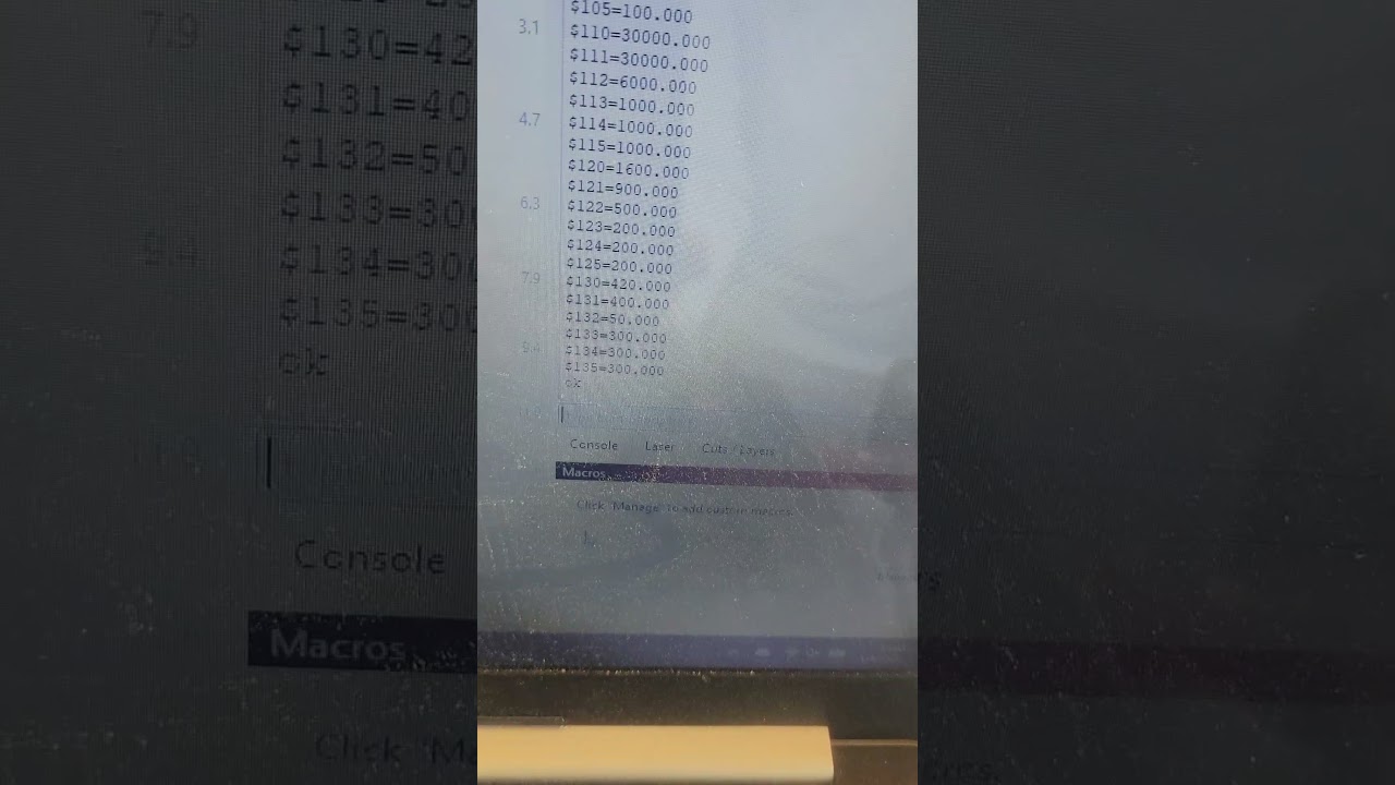

OK Gang just got the Acmer P2 33w. I cannot get it to connect to my network it is stuck in AP mode cannot get it into STA mode. Using Lightburn and have tried with MKSlaser. I have tried many different $ settings still no cigar. Got to get it out of AP mode Thanks for any and all help

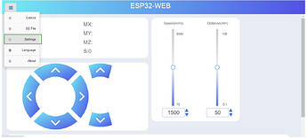

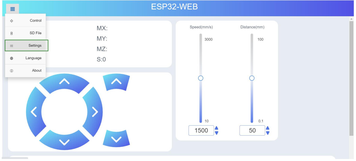

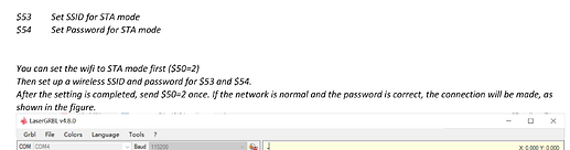

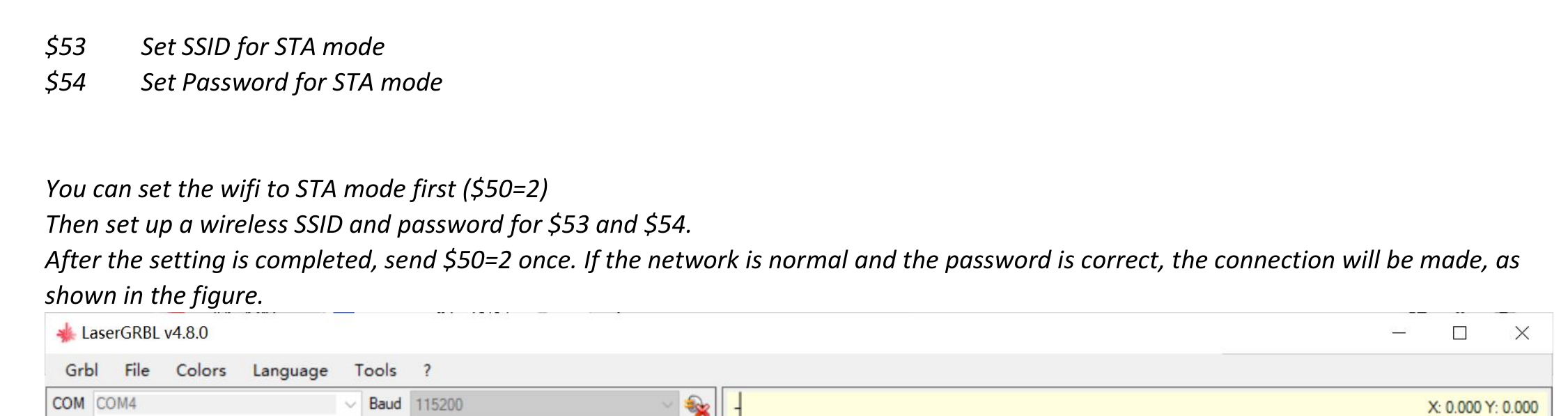

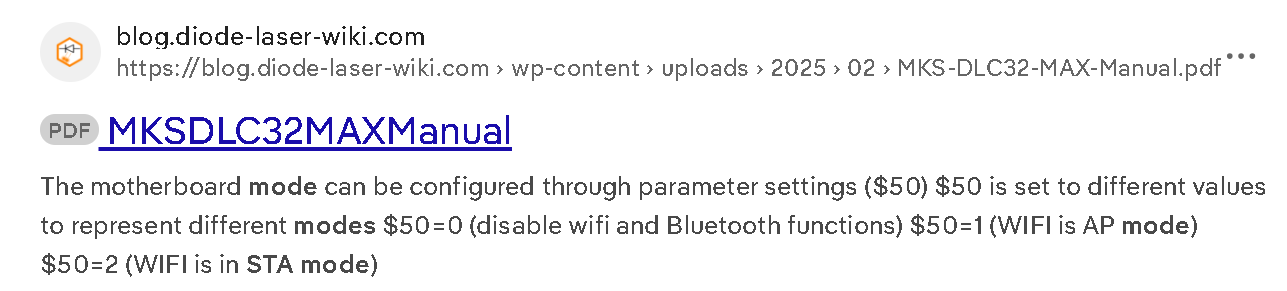

Connect with USB and type $50=2 then press Enter key in Console Window:
