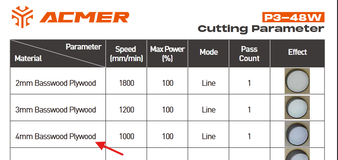

How about S-Value Max? Does it match $30?
Max value is 1000
Did it work before you cleaned the lens and not after?
Before, and after. The lens is clean.. Some say that frequency may do something with it, I don’t know what does it mean..?
Check here (a voltmeter will help):
Do a wall test, check your power-supply, for broken wires, and for loose connectors, sometimes the metal connectors slip inside the plug and cause poor connection.
Accurate focus is key.
The Acmer 48W should cut 4mm Basswood at 100%, 1800mm/min (Not mm / second!) in one pass.
I always use Metric, not Imperial measure. The problem is that Acmer does not have power.. 4mm plywood will burn throw if the adjustment is about 48w/ 100% power, 4mm/sec.. New power supply..? Does it matter which plywood you burn..? Mine is very hard, but wood anyway.. (Sorry my bad English..)

My point is that 4mm/sec is 60 times faster than 4mm/minute
No. This is either a settings issue or a problem with the laser diode. (Review Parsec’s link about Mechanical maintenance.)
