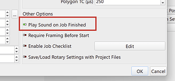

Hello, I’ve updated Lightburn to the 2.0 version but for my galvo laser it doesn’t play the usual sound anymore when the job finishes. Is there a setting anywhere or how do I fix this issue?
Hello,
Is “Play Sound on Job Finished” still enabled in your Device Settings?
If this setting is enabled and your speakers are confirmed working, which version did you install? (You’ll find the exact version number at “Help > About LightBurn”).
Yes the setting is enabled and the audio device is working. I think lightburn might be using a different audio device, but I can’t see which one. The version is 2.0.02.

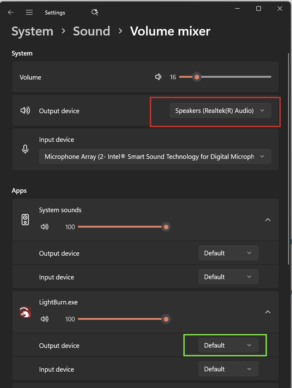

By default, LightBurn outputs the finished sound on the “Output device” marked in red here:
But, it’s currently required to restart LightBurn if you add another audio device while it’s running.
Can you confirm that the sound plays on the correct device after you restarted LightBurn?
(It is also possible to select a different one for each application in the Windows Volume Mixer (marked in green).
On macOS (Monterey), the finished sound played on the Bluetooth headphones, as soon as they are connected.
Thank you for bringing this to our attention. If you can confirm my theory, I will gladly pass it on to avoid needing to restart.
