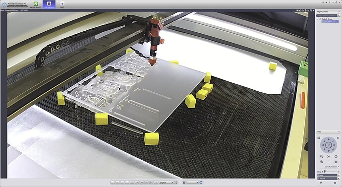

Add On to Monport 130w
Well I decided to re-install the Laser tubes Red dot attachment again after the first try that failed due to extreme low power reduction…
Edit: This is a Yhongli Red Dot specifically made for the Yhongli 80-150w tubes, screws directly on to the tube end.
When I first installed it I did a bench mark power test with two power meters HLP-200 and the Mahoney 200 watt version.
Ed Nisley did a great write up on the HLP-200
https://softsolder.com/2024/12/25/hlp-200b-laser-power-meter-first-measurements/
I found an almost 15w drop in power, so when I found time to investigate, I tore apart the Red dot unit and took a good look at the lens installed… It was in, “not so good shape”,
scratched around the edges a bit an just did not have a consistent coating, looked patchy… So I found a replacement at American Photonics and ordered one to give it a try.
The specs on their beam combiner lens was 99.8% transmission…I’ve spoke with the folks at APC a number of times and bought custom 3" lens and mirrors, and all of the products were super quality, so I figured the Beam combiner lens would also be the same…
After I recieved it and installed it in the Red dot unit, it was titme to do a power test…
I had my bench mark test, Fixed positon on the bed , Front and Center as I wanted a true power value thru the Red dot lens as well as mirror 1 and 2.
Set to 50% power,
Bench mark read 68W on both power meters.
Now I repeated the test with red dot… Exactly the same, actually read 1/2w higher in the HLP-200, but the bottom line was, the lens was working as I hoped… Success…
This was good to see as I hated the ‘hanging red dot’ indicator off the lens…
Now I had to alight the Red dot, welll after three hours, finally got it to with in 1/2 mm of the pulsed dot test on some birch wood 20% power 30ms pulse. Happy with that for now…
Next I had to install a 4mm air hose to the Red dot unit for cooling, I used a wye adapter off the Monport small air asisst pump and piped it up to the Red dot unit and plugged it in…
I still need to install an inline water filter to help keep the air flow dry which now goes to the nozzle and the Red dot lens.
The next issue was drop the intensity of the red dot, as we all know the dang red dot is bright, so using the power cable in the head that was attached to the original red dot hanging unit, I installed a 250ohm pot on the back side of the laser head for easy access and wired it in series with the 5V going to the New Red dot beam combiner… Had to play with the Resistance values for this unit and found 250ohms worked well to drop the intensisty to about ‘off’.
So now it is nice viewing on the materials, and I can increase it as needed, like on acrylic…
That was a 6hr project but well worth the final outcome.

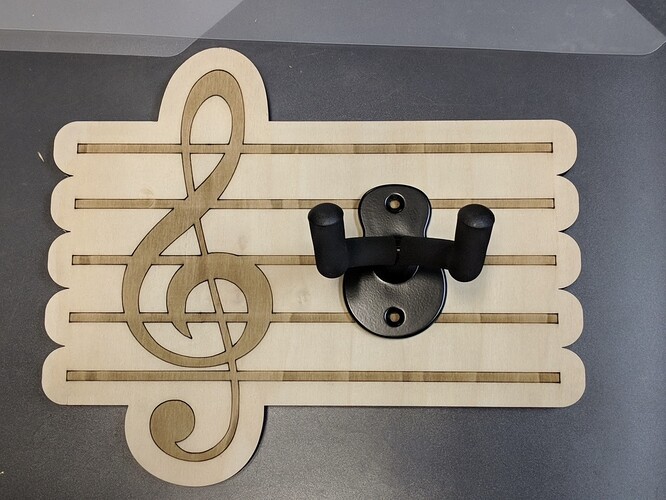

Another project, I was making a few items…
DID Puzzle for a friends wife. you can se the 20psi keeps the cut corners clean.
Guitar wall holder, engraved the lightly line cut to give it some outline.
Tea light flameless holder for your side table…
Wall clock 5mm Black acrylic, with a chip board backer…

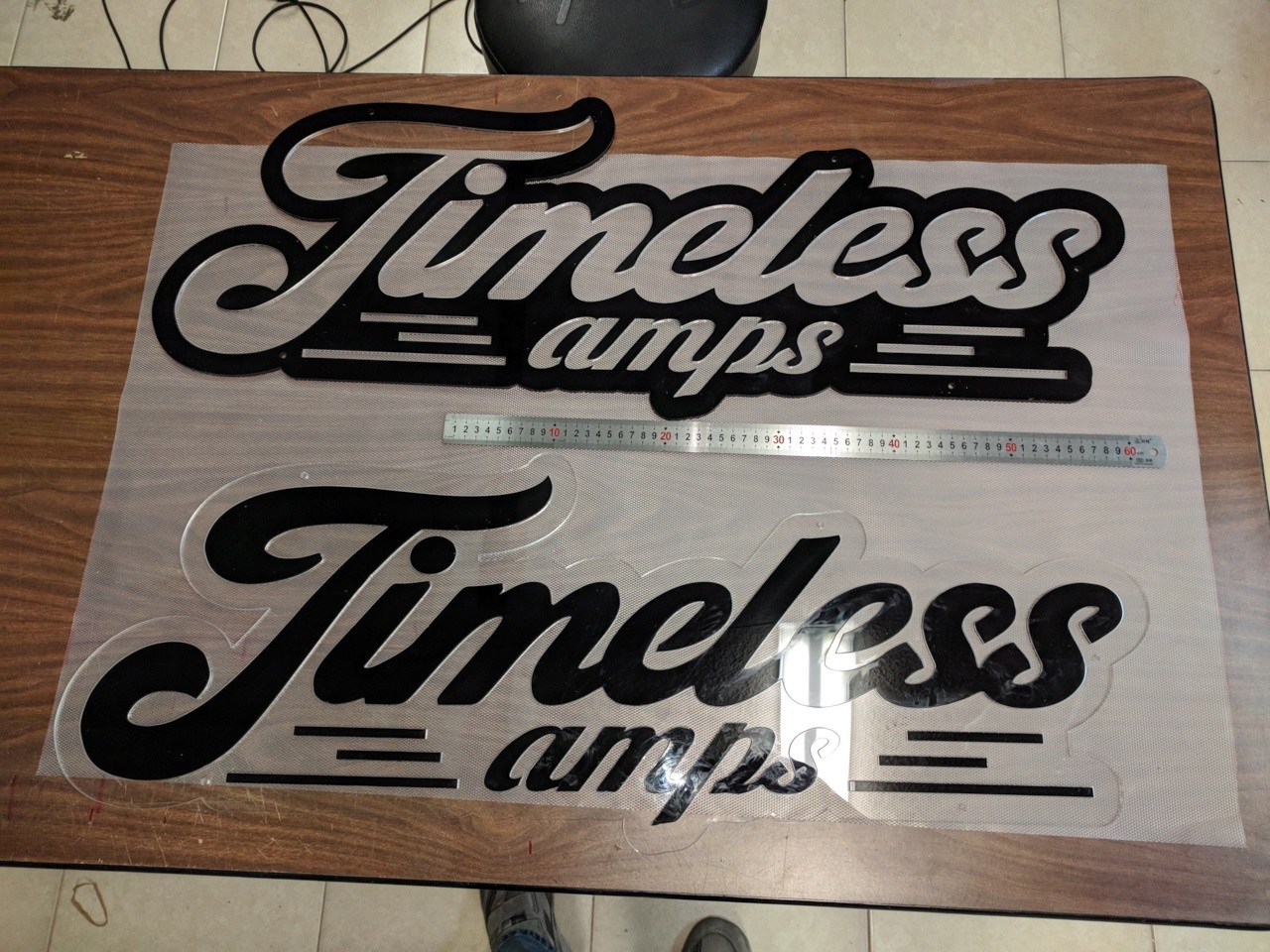

Lots of projects going, Opening our Custom TIMELESS AMPS store soon,
SOUND CREW STUDIOS store on Reverb.
all vintage handwired guitar amps…
also a few trinkets we will be selling on,our store.
And our Stereo Light Organ , smaller unit 14 bands, there will be a 21 band unit. We are working on our new board design and custom software…
