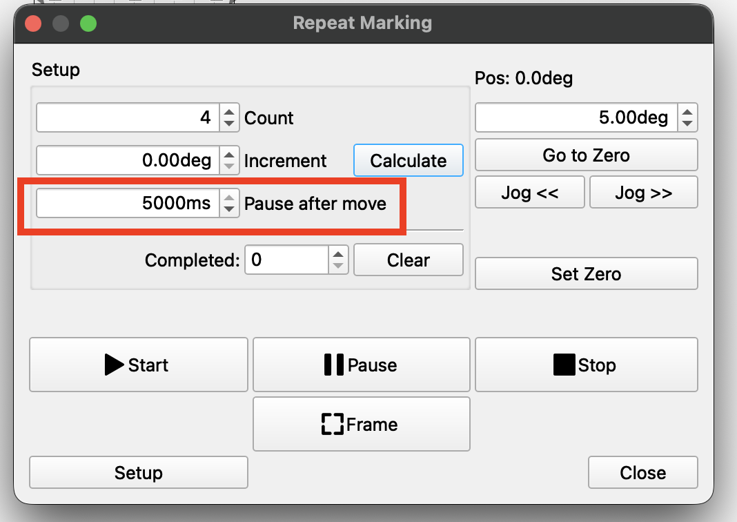

I don’t have a fiber, but what if you use the repeat marking dialog (Laser Tools> Repeat Marking) instead of the repeat button in start. There is a place for pause in that dialog. Worth trying, I think.
Hmm, wasn’t aware of that, thanks! That would definitely do in a pinch, just ignore that it thinks it’s for rotary and let it mark as usual.
Everything I do is custom engraving, so I never needed Repeat Marking. But I read up on it to understand what it is. I did see the rotary must not be enabled to use it, even though you can use the rotary.
Yup, that’s a bit like EzCad’s rotary mark feature, it’s for when you want to mark a complete single shape “flat”, so good when you have small repeating decorative elements around a cylinder. Could definitely be hacked a bit to use for adding a delay.
