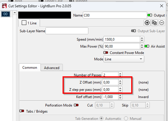

Is it possible to add a focus parameter for each layer? It coud be a percent for out of focus burning, where 0 is in focus and + or - could be for slightly putting the beam out ot focus. This can improve offset fill or enlarge line size with a single pass
I don’t know if I understood correctly, but you can enable the z axis and set a different z-offset for each layer or even for each pass:
Check out this post from w while ago. I had this same question and did some research on how it works and what issues you may run into.
Hello, thanks for your replay, also Melvin pointed out that the possibility is already there..
With this we can obtain larger engravings without using multiple passes.
