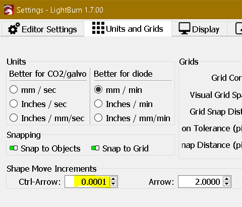

You can also zoom all the way in and set Lightburn to 100 micron adjustments with Ctrl+Arrow
