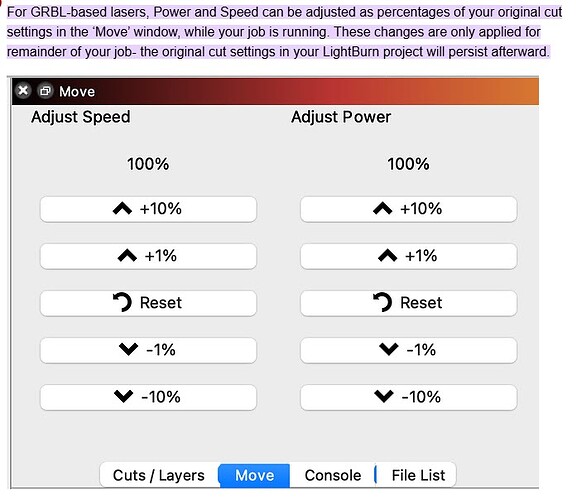

Novice again. Can you change the strength and speed once you start engraving? It would be great when you see that the strength is too strong or too weak. I tried pausing and adjusting but nothing happened
Yes. when running your job there is a screen that should display that allows you to adjust the power and speed while running. But at least on my version if you increase the speed it also increases the power and vice versa
I think this applies if you are using variable power. The controller makes the corrections, which it is supposed to do. Try with constant power.
I always use constant power. But i have an older version of LB. Like 1.4 i think
