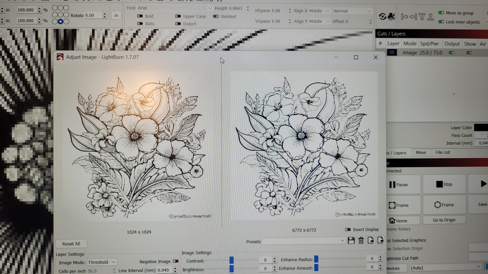

Hello, I have a jpeg. I import in into LB I open adjust image. I finish adjusting, I see my changes. But when I hit ok, my workspace picture does not change to match the preview. I adjust the image so I can trace better. Why does it not not work?

I have it installed on three different machines. All do the same thing. Heres the picts. First photo is all three. Work space, adjust image window and you can see the right window is different from the left(original). I click ok and get the second picture. No change. Same as when i imported it.
Im not new to lightburn. I always edited my picts outside of LB. I decided to try it and i dont think it works corectly. There is litteraly no change to the desk top and you can clearly see its different in the preview window. Am i missing an apply button somewhere?

I am not going to be much help here. Your Adjust Image window shows a difference, but the one in the back is zoomed in really far making it impossible to make a comparison.
I did notice you have Threshold mode selected. You do know this is strictly a yes/no mode and there is no adjustment for shading in any form.
Have you actually burned a partial of the image to see if your changes are happening in the end result? What does the Preview window show?
