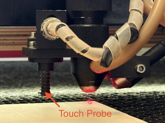

A laser I’m using has a Touch Probe for focus where the auto-focus is set for a 2.5" lens.
Now I would like to consider changing lenses to different focal lengths, e.g. 2" or 4".
Where in Lightburn settings can I set a focal offset distance on a Ruida 6442?
If I recall correctly, in LightBurn, go to the Machine Settings - then under Vendor Settings, look for U axis, I think you want to adjust the Homing Offset to match what you have tested to be accurate. You can find that distance with a ramp test. :slight_smile:
This can also be set from the HMI of the control panel, but I don’t recall off the top the exact sequence to navigate. That route would be better to review the Ruida docs for the specific model.

I crawled through that with my KT332N, which uses different terminology but is maybe similar enough:
Basically, with the focus “pen” / probe / switch at a level that does not crash the nozzle, set the Home Offset to fully release the switch, then set the Focus Distance to match the lens. Your terminology will be different, but that’s the dance.

I would take a slightly different approach to most people and set the Focus for a 2in lens, then cut a 1/2in and 2in spacer to drop on top of material to adjust for the most common lens focal distances 2, 2.5 and 4in.

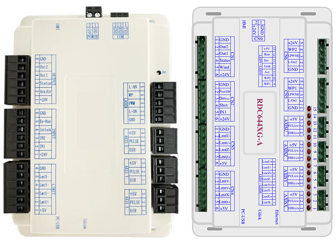

@NicholasL and I appear to have the same controller, however, his will run a rotary off the U axes and mine will not. We do have different firmware versions. How the power is applied is also a seemingly anomaly that appears to change between our firmware versions.
Growing up around the new controllers, at that time, it was relatively easy to brick one, so anytime a firmware upgrade is mentioned, I am a bit uncomfortable. I say don’t do it unless there is a very good reason.

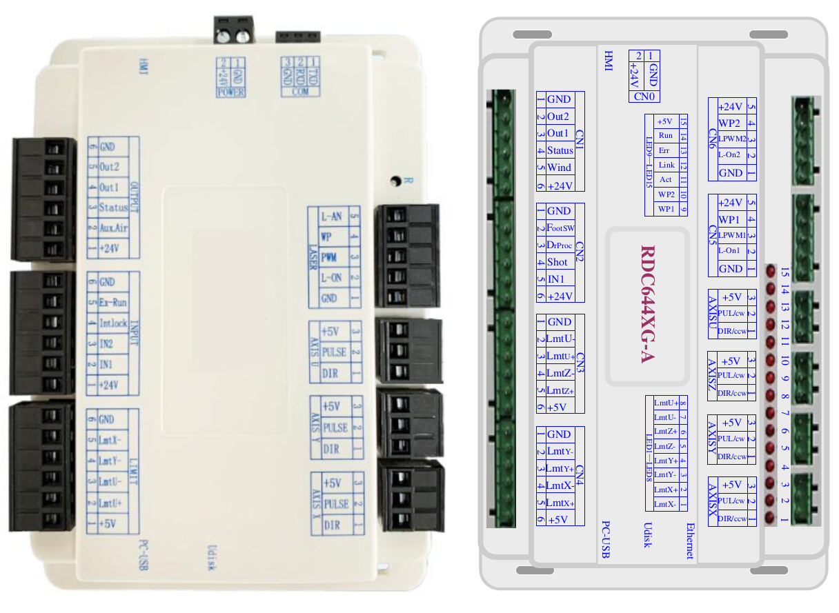

If you compare the KT332 physical layout with the Ruida, they are very close.
All the outputs are in the upper left, middle are inputs and bottom is the home and limit inputs. The 644X series have a Z control, which adds another connector but same relative layout.
On the right side of the controllers, which can control two tubes with the Ruida. The remaining are for the stepper motor control
Working around these, I highly doubt this was built by someone other than Ruida. This just doesn’t seem to happen in the real world that I’ve lived in. I’d say they are both Ruida controllers and the KT is a lower cost variant of the 644X type, lacking a Z and multiple tube controls you have a basic system that is functional for a majority of hobby and low end manufacturing applications.
It’s likely they could easily map something going to the Z axes to the U or just change it to the U/Z axes are the same.
I have a document I found, that claims there are both Ruida controllers… Of course there is no guarantee it’s actually from Ruida.
It would be nice to see inside one and which pal they used…
Just speculating, as usual.
Did you try changing the Focus Distance here? In Machine Settings > Miscellaneous;
If I increase the distance here on my 6442 the Z axis will back off more.
That’s what I meant, they could have used Z for the Z-axis and U for rotary or something.
Bottom line, I don’t care, the controller works flawlessly and I’m fine with the fact that it’s a cheap version from Ruida, which I found the same document on as Jack shows.
