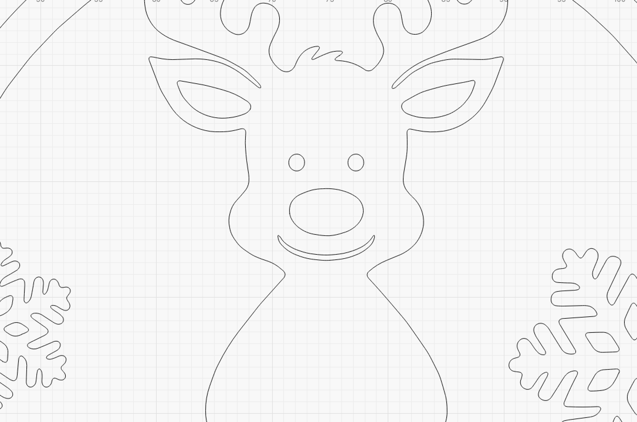

Your file probably has too many nodes, and small radius.
Indeed. I’m able to adjust the size up to mitigate some of the excessive burning and it comes out much better, using painter’s tape adds another layer of protection. But to get that predetermined size is impossible for my machine as it’s written. The original file must’ve been made using a much better unit.
Can you upload the LB file? Maybe it just needs to be cleaned up a bit.
I can edit the nodes to remove the excess. I have several of these types of files, this being the first I decimated.
3ddeerwithornaments1.lbrn2 (491.6 KB)
The file has no arc or curves, all short straight lines. The ornament with the snowflake has 1615 nodes.
Apart from the fact that there are way too many nodes and it’s not the most beautiful design (on a construction level) I’ve seen, there shouldn’t be any problems cutting it out, it just won’t look pretty this way.
I’m deleting nodes and changing the points to smooth curves. Minutia upon minutia but I’d like to see if this will work.
You can use shape optimization, first soften shapes then reduce nodes.
