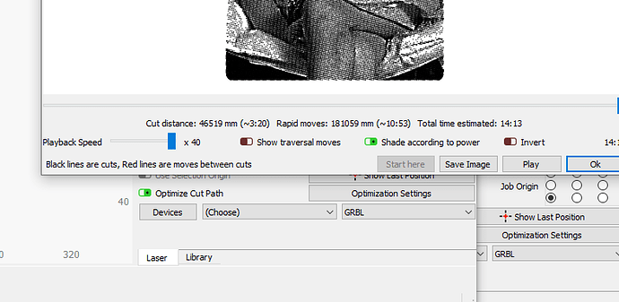

I will bring in an image that has been modified using the website image-r but results nothing like youtube video shows.
I am adjusting image in lightburn using “Adjust image” where it gives a before and after view, yet when I am satisfied with the image look then close that window and look at the “Preview” window the image is like not even 5% close to what I am seeing in the “Adjust image” window.
Any of the “image mode” I select other than “halftone” give me terrible results, I can make many adj. to image in halftone to get a image that is sort of decent but no where near what many you tube videos show.

You should post photo of the tile or the screenshot of LB…whichever or both.
Also…if you are saying the preview looks bad make sure you turn off transverse moves…turn on shade to power then zoom in on the photo. Dither always looks dark zoomed out…like a black silhoutte until you zoom in to the actual dithering.
Yes to the results on screen Preview before burn look dark or no detail at all, I have not tried to burn onto a tile as of yet. I do have some screen shots of what I am referring to. I will try zooming into photo as you suggested and see what happens. Although in halftone mode it seems to look not so bad but detail is still a little sketchy…
So here is pictures of what I see in half tone, only showing partial photo to conceal as it is of a friends children they wanted on tile… So this is what I see in halftone in “adjust image” and then again in Preview
And if I chose Jarvis, or Dither I see this, Picture looks alot cleaner and detailed but darker on the preview. And again I have not burnt to a tile yet as I was unsure of the darkness of the image:
You won’t like how halftone looks when engraved…at least I don’t….too many halftone dots.
The preview on the cut path screen doesn’t look like what it does engraved or at least not close. Dither will look dark until you zoom in….the preview at native resolution can’t distinguish all the individual dithering so it look black. When you zoom in you will see it more clearly.
However you have to burn some tiles to get an idea of what you see on the screen verses actuall burn. I find that roughly it is between what I see on adjust image screen and the preview slightly zoomed in. Remember that preview is mainly to show you the lasers path and burn or cut pattern I personally do not judge how the final burn will look as far as shading goes by the preview screen. I use preview to zoom in and look at the dithering in key areas since that is the exact pattern the laser will burn.
