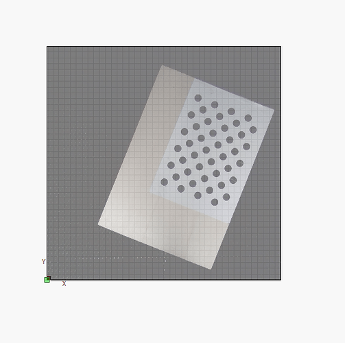

Regular-Profile:

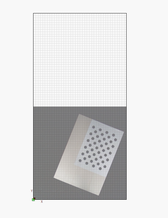

After switching to the extended Profile:
Thats great, thanks a lot!
