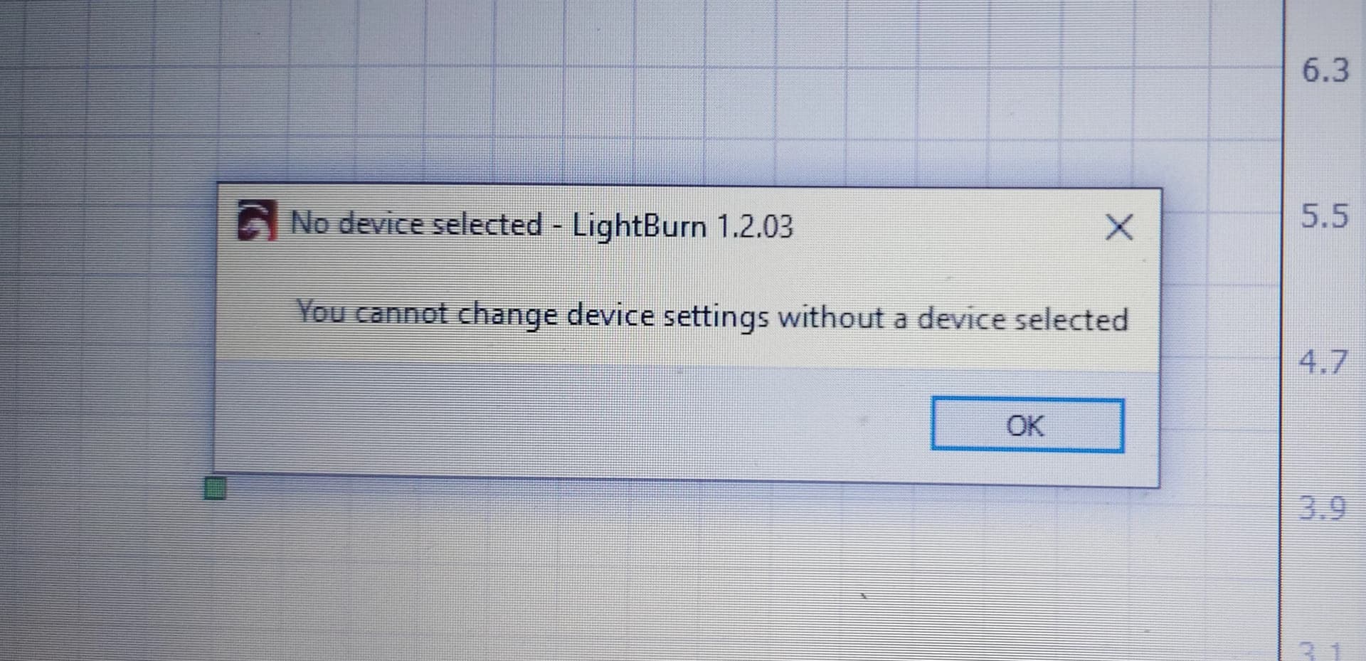

I have LightBurn installed on my laptop but I am trying to make the size of the workspace match the size of my laser workspace but just can’t seem to get it. When I click on the device settings, I get a message saying, not device selected. I have not connected this to the laser as I have 2 other computers that I want to design stuff on and i can’t connect them to the laser either because of where they are located. Just want the space on my software to match the laser. I contacted a lot of forums and one person said it could be a flaw but I’m not sure.

If the size of the workspace is still wrong once you’ve selected your machine, then perhaps your machine wasn’t correctly set up, and these settings can be changed in the Device Settings window (found in the Edit menu). The Beginner Walkthrough is the best way to learn more about that.

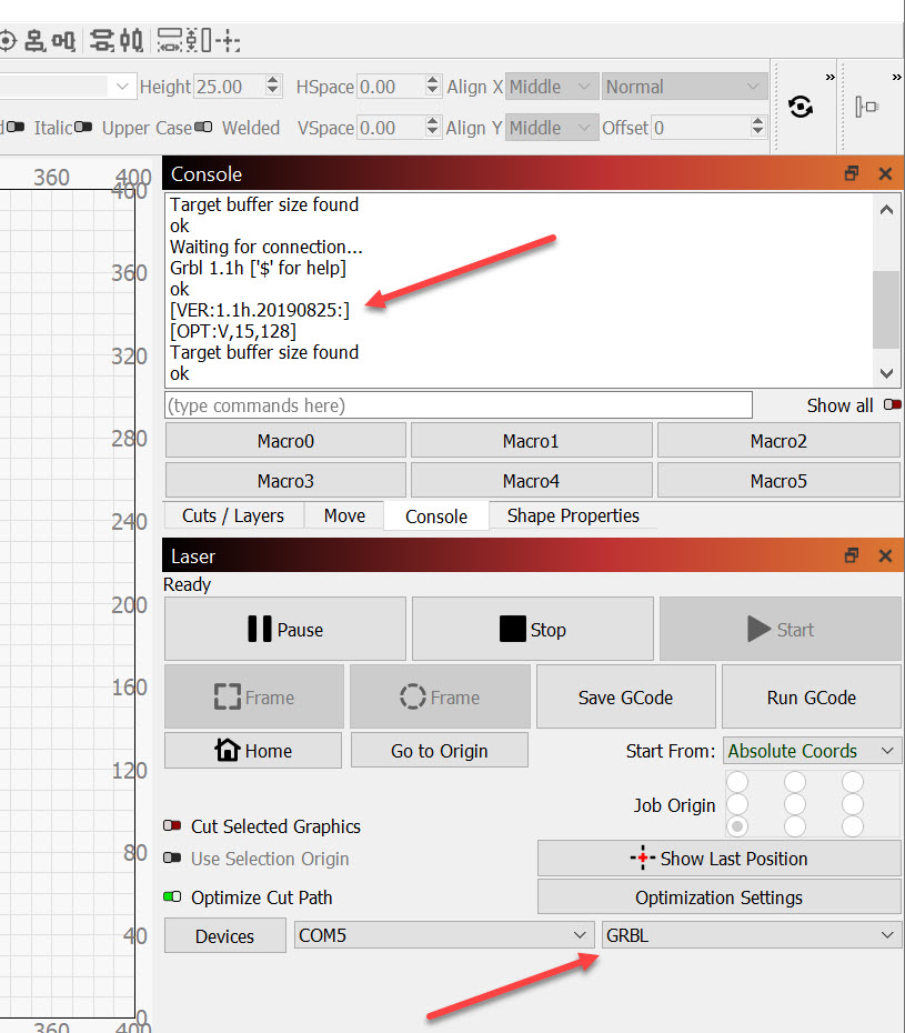

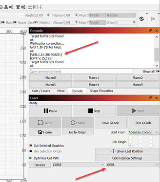

After the communication begins you can capture the welcome or wake-up message in the Console window in LightBurn and confirm which version of LightBurn you have on your controller. Knowing that it’s 1.1f or 1.1h (or any other version) is useful. The string of letters next to OPT: also lets us know which firmware options were selected when it was built.
For test purposes, please select GRBL (not GRBL-M3 or GRBL-LPC) and attempt to connect.
Once connected, even if you select some nonsense numbers (like a 10mm x 10mm workspace) you can ask LightBurn to read the default values from the controller and get going.
