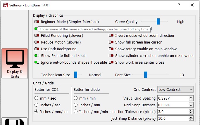

On my laptop inside my house I can get to Flood Fill. On the laptop attached to my omtech polar, Advanced tab does not show up to get to use flood fil. Cross Hatch also does not show up. I do have 1.4.01 version on both laptops. Do I have something turned off?
Please turn off “Beginner Mode” under Edit-Settings You should now see the advanced tab in your cut settings
example image
thank you so much
