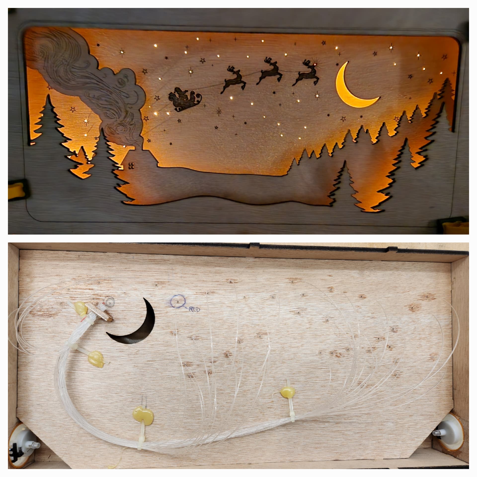

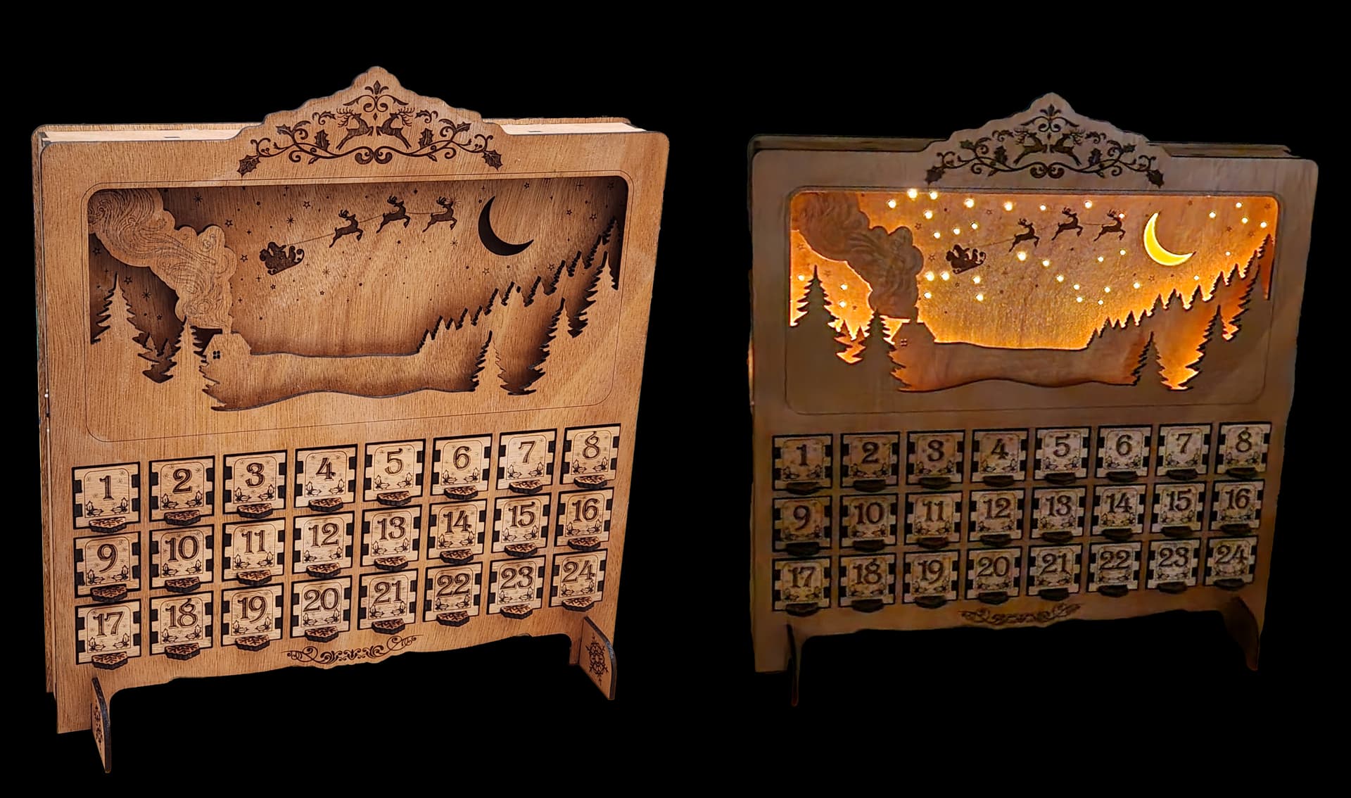

Custom designed advent calendar done in 4mm ply. Lighting done via 3 tea lights & optical fiber.

Nice! How did you make the stars glow?
Stars were holes lasered into the 4mm ply that matched some optical fiber I purchased. Fiber was super-glued (CA glue) into each hole, then the ends were combined and a tea light was placed to power the fibers.
@Grandpa_Laser , nice! I’ve been planning to do something similar with larger size fishing line. Do you see the need/performance increase for going with optical fiber over a fishing line?
Also, did you just paint the end of the red one or did you do something different?
Ive never tried fishing line so i cant speak to that. For the red end, i just used a red sharpie on that fiber dot.
