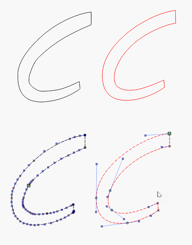

I did a free hand with a rectangle and added points to shape my polygon. I may have gone about this the wrong way. I tried to optimize by adding more points, but I will have some shapes that are not smooth curves. is this something that has to be shaped more by hand with the edit nodes tool, or did I miss a function, that better cleans this polygon up?
smoothing..lbrn2 (16.8 KB)

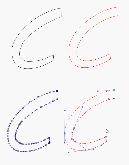

So I used the S option in the edit nodes tool. I think I am still getting a few points that are not full curves. Is it just my monitor just playing tricks on me?
To smooth that shape I think it would be easiest to edit the shape by hand, use as few nodes as you can get away with to give the curves room to stretch out which leads to a smoother path:
For example:
smoothing_less nodes.lbrn2 (18.2 KB)
thank you. That helps. I guess I could have designed with an ellipse.
