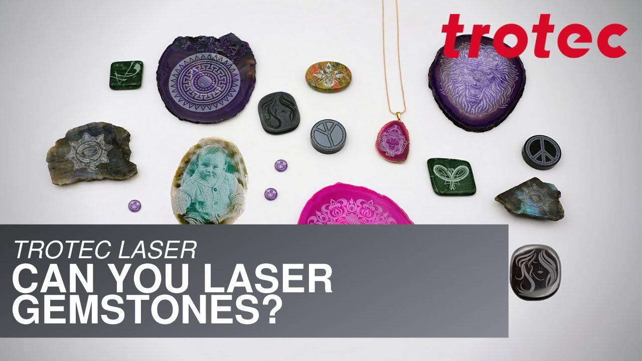

Here’s a video from Trotec that’s should answer your questions. Note the power of his laser…
I think, if you look closely, the material is shattering…
