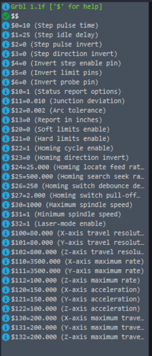

This are my current values from the console:

If your board reports the GRBL version as 0.9, You may have to use GRBL-M3 as the device type. Just so you know, that is a really old version of GRBL.
If it is v1.1f or later, select just plain GRBL as the device type.

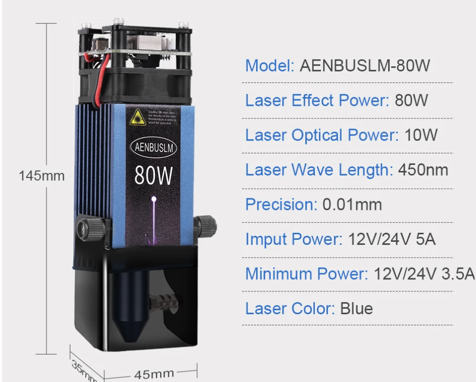

Yes, your power supply is seriously inadequate. For a 10w optical output laser, you need 85w minimum. I recommend you replace it with a 120w supply as a reasonable energy safety margin.

Thanks for the info, MikeyH. That makes sense about the GRBL version. I didn’t realize that could affect how the laser is controlled. I’ve seen some setups where $32 needs to be set to 1 for laser mode to work properly, so that might be something to check too.

This is a major problem as most of these control boards are limited to about 25W of current to the head and can’t supply 80W.
12V at 5A is only 60W, so you’re under powered for your laser module and likely attempting to draw too much current for the control board.
When you do this, it’s an advantage to use a 24V system, if you can. That cuts the current draw in half.
80W/12V is 6.666 amps, whereas 80W/24V is 3.333 amps.

On the controller board there is a writing that says “grbl0.9j+”
But when i connect the controller to LightBurn it shows that the firmware is v1.1f and i have selected plain GRBL.

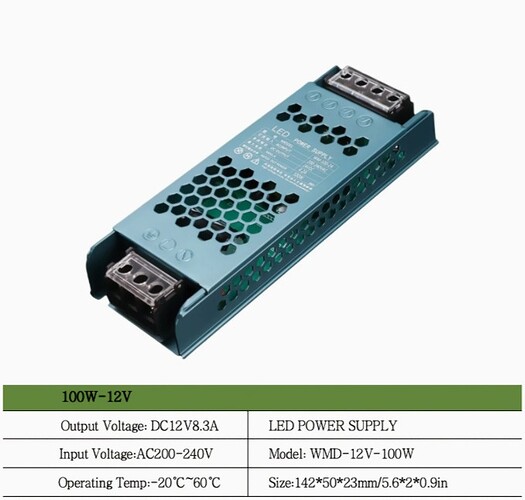

This is the new one it is a 12v 8.3A 100w could not find a 120w one. I hope this will be enough as it will be dedicated to the laser module only, do you think the 8.3A will be too much and burn the laser module as the module is rated on 5A?

This is likely the board version number or numbering system. It currently has the 1.1f version of grbl running.

The power supply does not push current, it delivers what is demanded. As long as the voltage matches the laser, you will be safe.

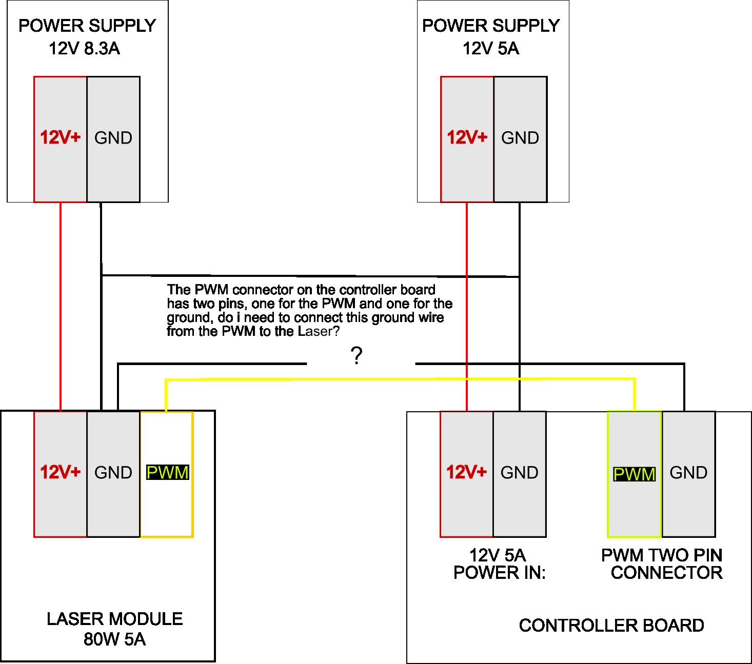

I made a diagram from what you wrote me about the wiring, i will use two separate power supplies one for the laser module and one for the controller.
On the controller board the PWM is a two pin connector one pin for the PWM and one for the ground, my question is: do i need to connect this ground wire between the PWM and the Laser module?

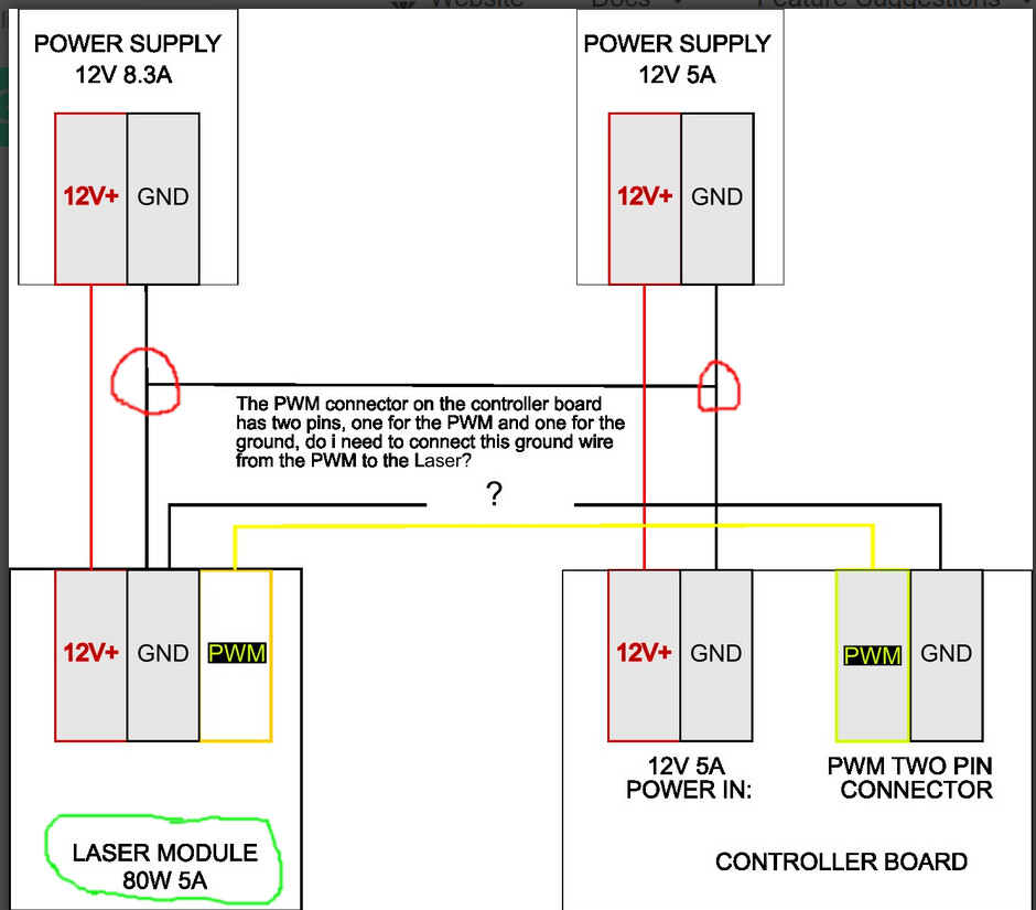

The grounds that I have circled, in red, connect the controller and laser module, that should be fine for a signal.

The one thing that i am not sure is about the PWM connector on the controller board, it has two pins PWM/GND, do i need to connect both PWM/GND (two wires) to the Laser or one wire for the PWM only is enough?
Follow you about the two power supplies. PWM is only a digital signal, so as long as there is a common ground for all parts, you don’t necessarily need to use that pin, but there must be a general ground for any signal.
The two lines circled in red should handle your ground system fine.

Like @jkwilborn said, tie all the commons together. for two power supplies, this means the negative terminals too.
I have commons only at the input of the supplies, the outputs of both supplies are only two wires negative and positive, should i connect the commons at the input of both supplies?
