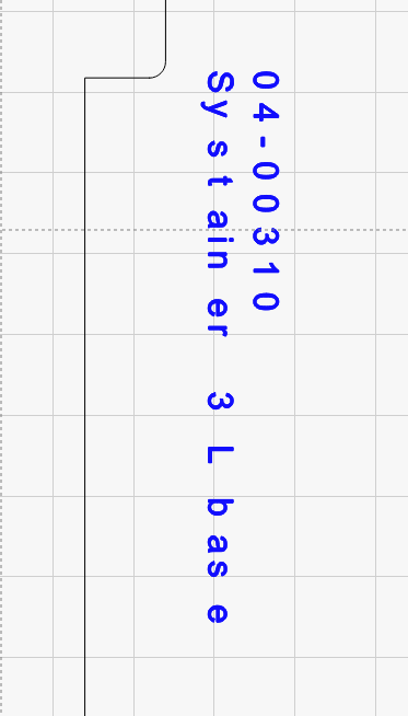

@Marcus_Wakefield Nearly there. I did one PDF export from AFD2 and then dropped it on LB and it looked great. It didn’t have text in it.
I just did another PDF, attached, and though I can see text in a PDF viewer, when I put it in LB, the logo shows up by the blue text does not.
Any thoughts on this?
Note, I changed the file extension to .txt so it would upload.
Sys3 L Base Master.txt (20.1 KB)
IIRC LB doesn’t import text in a PDF (I could very well be wrong on that though). I thought there was an option to convert text to curves in the PDF export dialogue in AFD2 but I couldn’t see it so I selected the offending text and performed a ‘Convert to Curves’. I then exported and that worked when I imported to LB.
I’ve noticed that the blue text on my system doesn’t look the same as the PDF you uploaded but I put that down to not having the same font on my system.
I really appreciate your help. Though it is frustrating to run into trouble like this, I’m thankful you could help me find another way to “skin the cat”.
I was able to convert the text to curves and then export as PDF. Not ideal, but it works.
