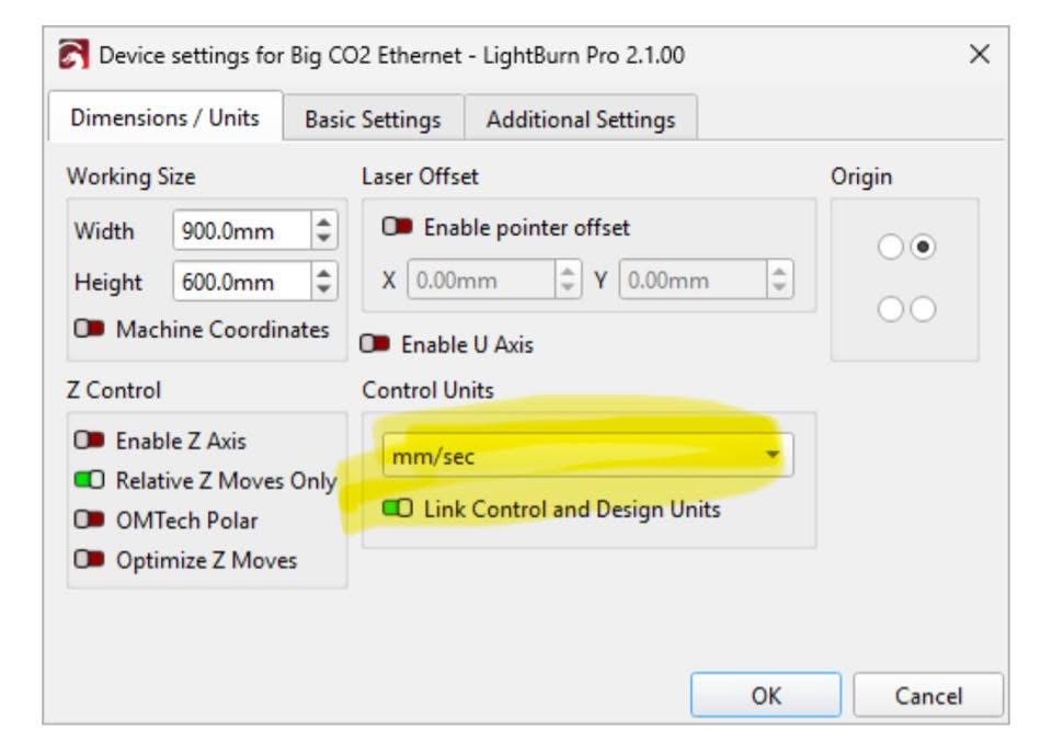

After updating when opening a file the speed/pwr in cut/layers is different. If I change for example to cut at 12/65 and send to laser it shows on laser as 5/65 and is too slow. Another example one that has fill was 400/25 and it ending up being 169/25 on laser. I’ve wasted the biggest part of the day working on this and can’t get it to work correctly.
Check how are your laser device units set.
I am having the same issues. loaded 2.1 yesterday, and now having to run machine, at 5/100 to get it to cut, where previously it was 120/100. I have checked my settings and don’t know what to do. all my settings are screwed up in this manner. Help?
“5” is not a speed without units - it’s likely 5 inches/sec and was previously 120mm/sec.
Change to mm here in the device settings:
You likely want to turn off the “link” switch underneath, which is making the inches in design force inches for speeds.
