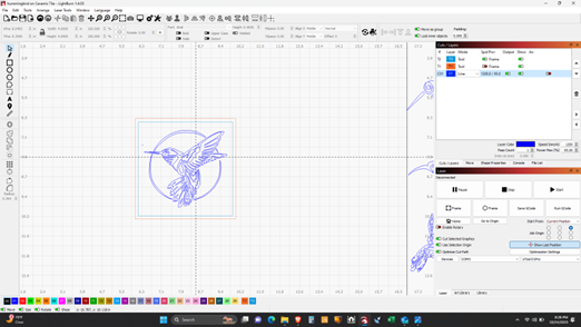

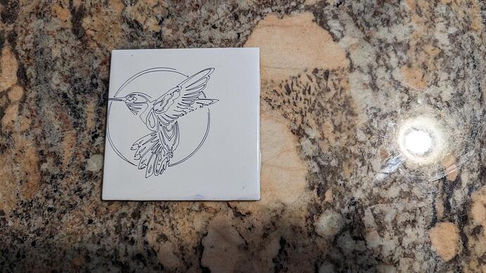

I have been using LB for nearly a year and have had excellent results. After I upgraded to the newest version of LB I found this issue… Framing fine then engraving off the material to the left. I have done this design multiple times previously on the same material successfully. I decided to run a test to confirm it was not the machine. I loaded my design into Xtool XCS software and the job ran flawlessly. This leads me back to LB. Looking for any other suggestions why LB might be doing this after the update?

  1. full screenshot with the design loaded and ready to burn

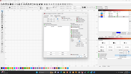

  2. screenshot of Edit->Device Settings
  3. photo of the resulting burn

LB Image Work Area
LB Image Device Settings

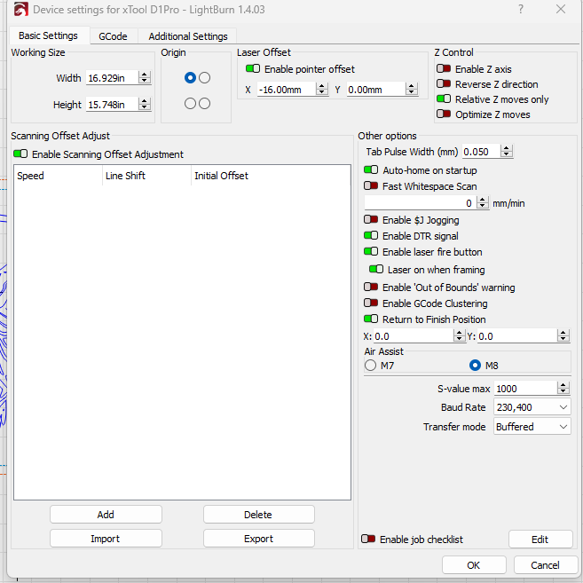

Better picture of device settings
If you’re using the blue diode for framing then disable the “Enable pointer offset” in Edit->Device Settings.
Then retest.

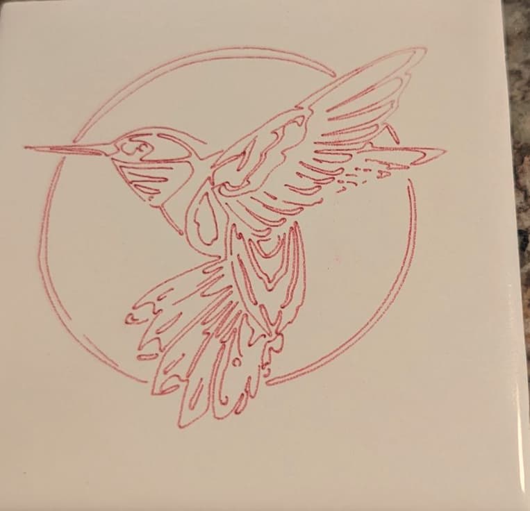

Seems that was the issue. Solved! Thanks for your help!
