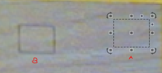

I have it semi working but still wont line up my image a= original (my request) b= where it burned no matter what I do I cannot get it to line up it did before in earlier ver.
following from my last post should have mentioned that calibration /alignment all pass as they should any advice welcome

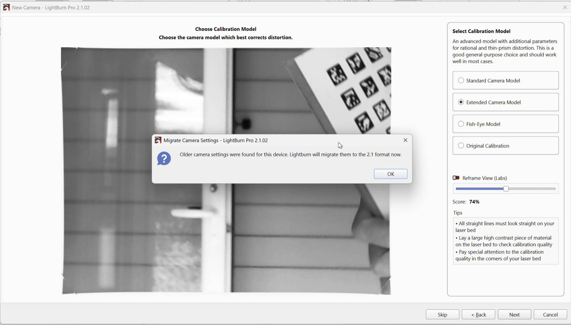

It sounds like you’ve been affected by this:
The “New Camera” wizard, for some reason, detects your old camera settings in this step, and forces you to import them.
I’ve already reported this internally.

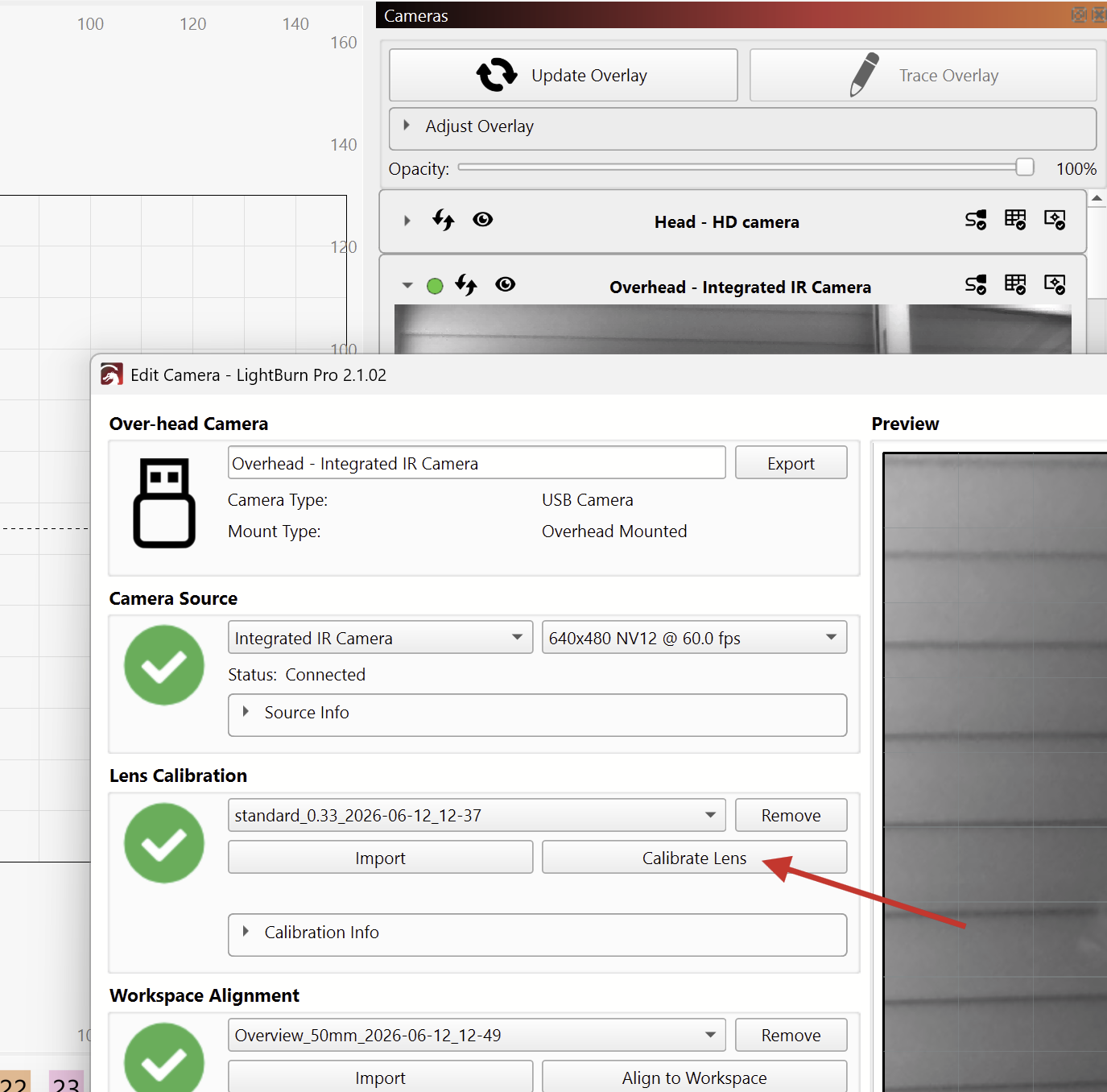

As a workaround until this gets fixed, you can start the Lens Calibration wizard from the Edit Camera window instead:
Double click the camera preview image, and click here:

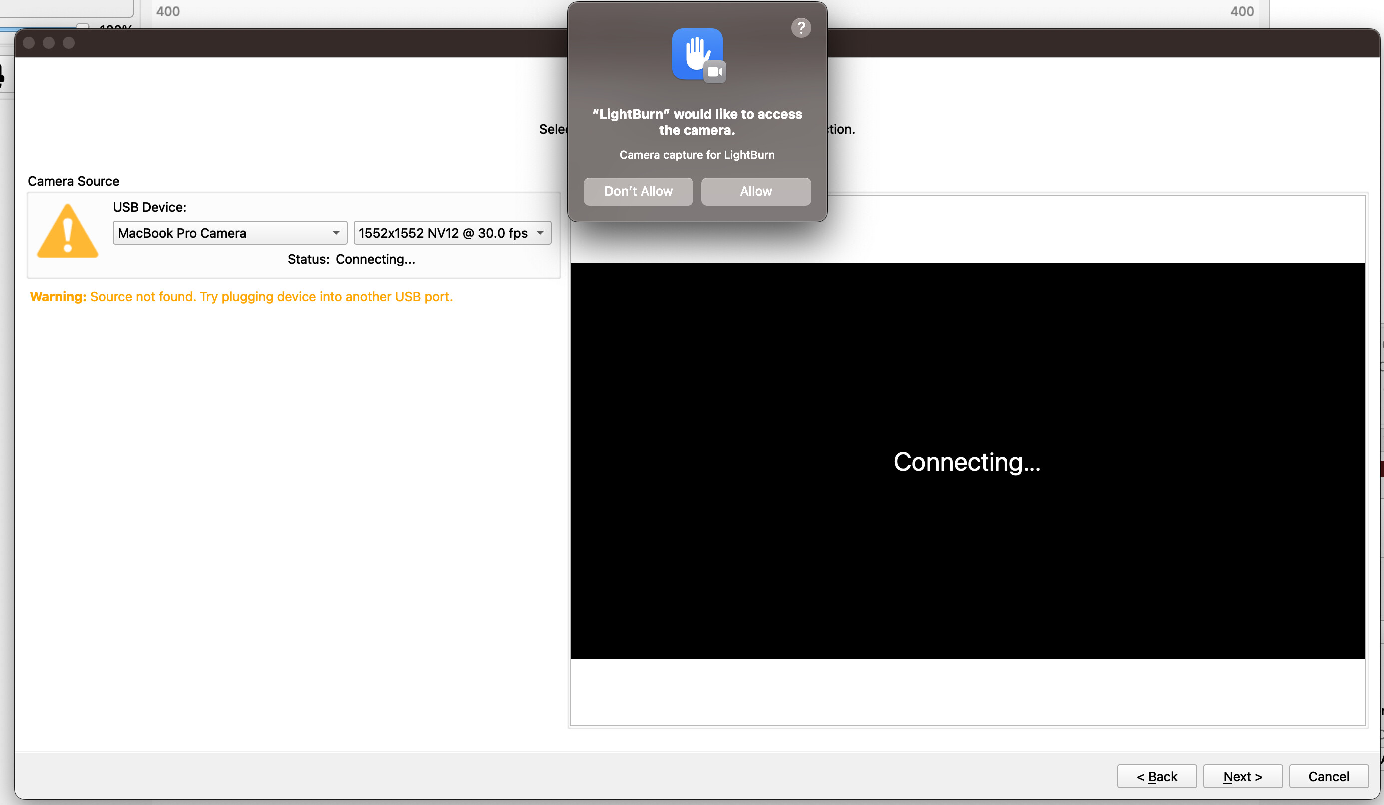

I am sorry you are experiencing these issues! Are you maybe running Lightburn on a mac? And does this happen for all cameras? If so, it might be a permissions issue. You should always install Lightburn in the Application folder and make sure to click allow after installing in the dialog like the one bellow after running for the first time.
Or does this only happens with one specific camera? Then maybe try using a different USB port and always make sure to use a high end USB extension cables. Please also share which camera you are using?

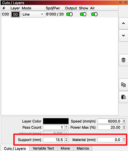

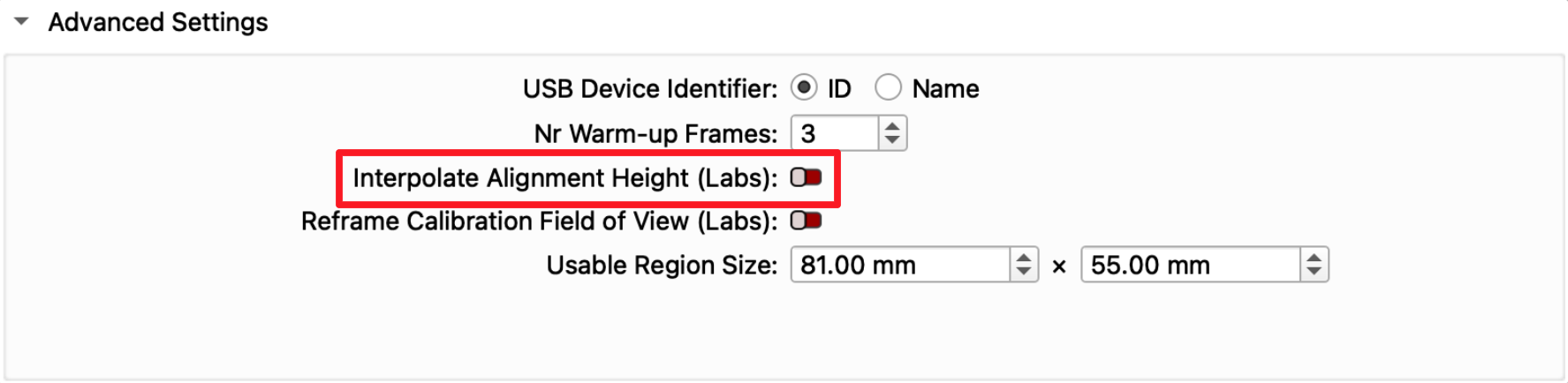

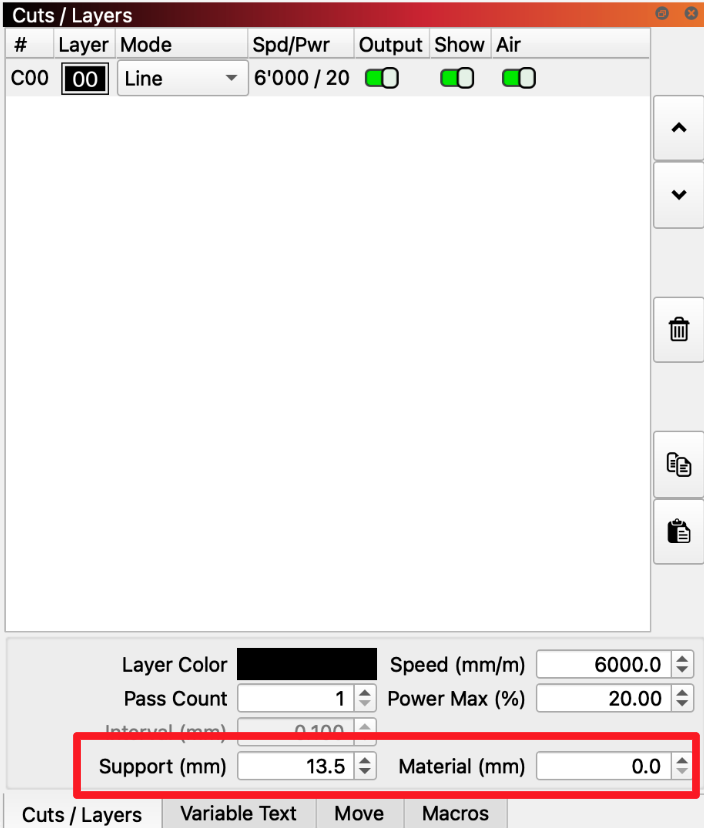

Does your device allow adjusting the Support and/or Material height? Does it have the fields shown in the image bellow?
If so, and if you have have more than one alignment, lightburn might be interpolating between these alignments when you update overlay, based on the values set in these fields. The easiest fix is to turn this feature off in the camera edit window advanced panel, see image below. This will return the behaviour that the overlay image is only every effected by the currently selected alignment.

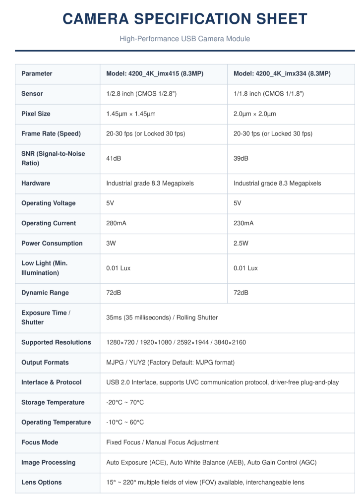

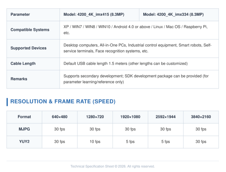

I only have this one USB camera hooked up. For reference, here are the specs for my module (I have the IMX415 version):
  • Sensor: 1/2.8" CMOS (IMX415)
  • Resolution: Up to 3840Ă—2160 (4K)
  • Output Format: MJPG / YUY2 (Factory default is MJPG)
  • Protocol: Standard USB 2.0 / UVC (Plug-and-play, driver-free)
  • Focus: Fixed Focus / Manual Focus Adjustment

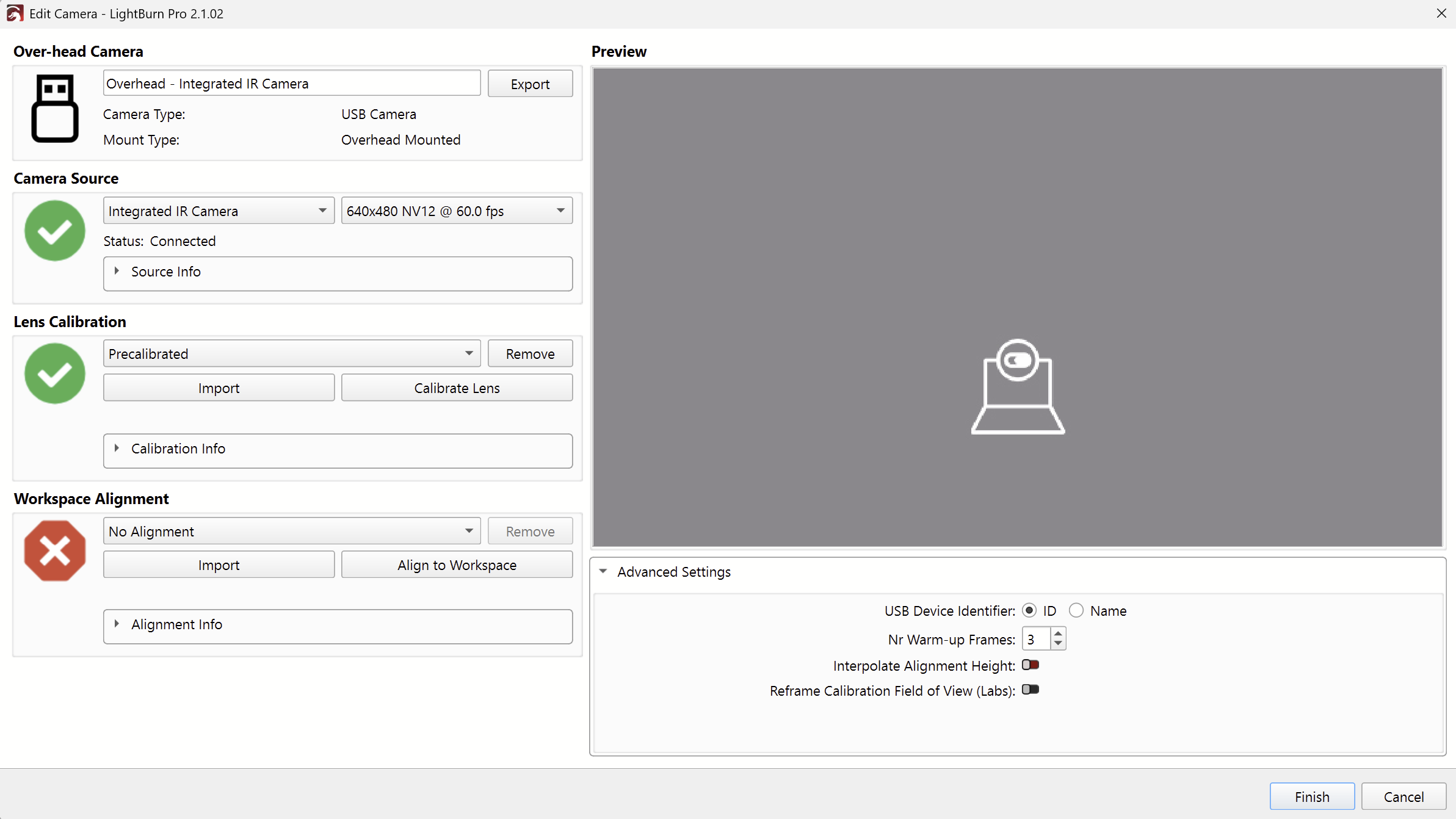

On Windows, open the “Camera privacy settings” and check if “let desktops access the camera” is still enabled. The “Recent Activity” tab should also list LightBurn.
Does the camera still work with the Windows Camera App?
If possible, send us a screenshot similar to this one with “Advanced Settings” showing:
