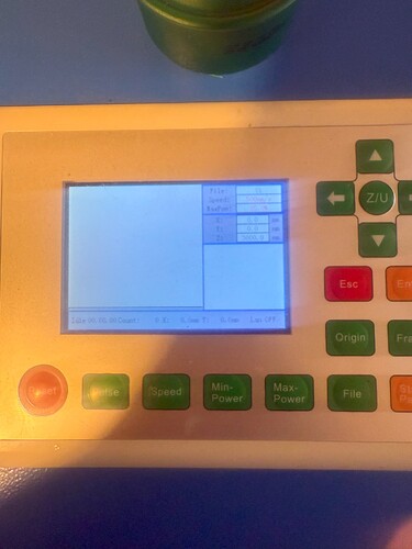

Does your machines console have any information in it?
Is it showing an increasing process time? Mine tells me the job time, but it counts, wondering if it thinks it’s still processing the job.

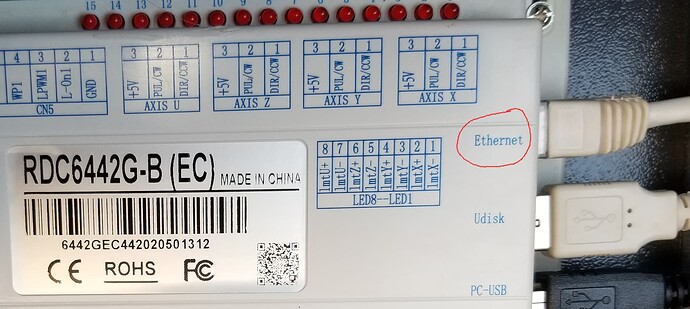

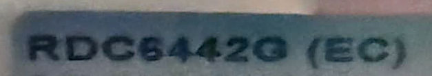

Your profile lists the controller as Ruida 644XG. Is there a more specific model printed on the back of the hardware, like 6442 or 6445?
Is it connected to the PC by USB or Ethernet?

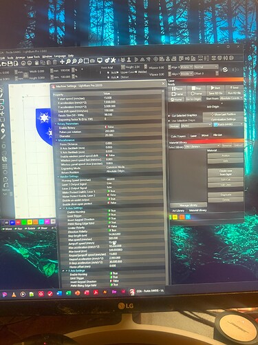

Per @jkwilborn’s recommendation, is the controller set to return to the machine origin at the end of the job? The 6442/6445 doc calls the Back Position, but that verbiage likely does not match what you’ll find in the Machine Settings or on the controller’s display, so a screen shot / photo will help us see what you see.

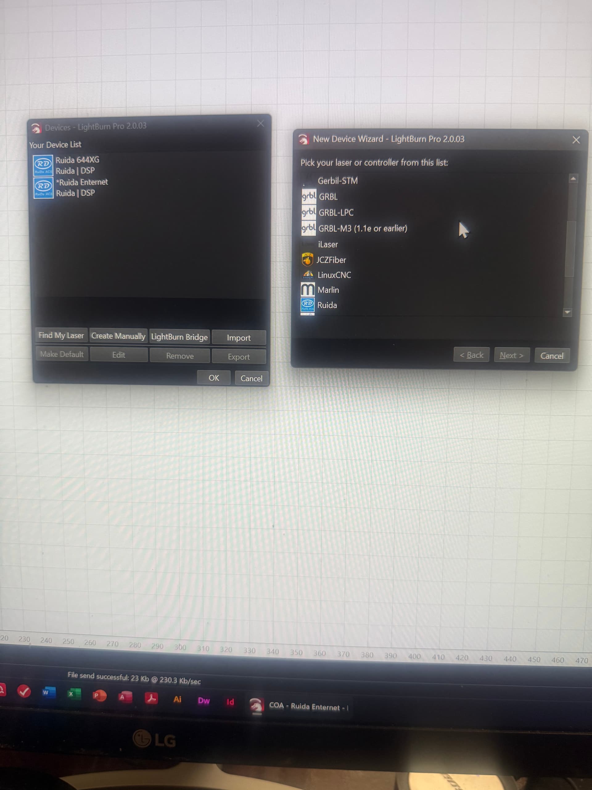

Do you use LightBurn’s Send or Start to get the job into the controller?

Do you use LightBurn’s Send or Start to get the job into the controller? I’ve done both but is send then go to the machine and frame and start.

Can’t see the other end of your controller in the photo. Never seen a 6442g without an Ethernet connection.
I don’t think you have any control over the file system on a Ruida. So, I don’t follow what you could have done.
I just tried 2 other bought designs and same thing occurs. They look completed but according to the controller panel It stops just short and locks up.
Frustrating.
Son-of-Gun you are right. There isn’t a hole to route the cable to, but I will make one for sure.

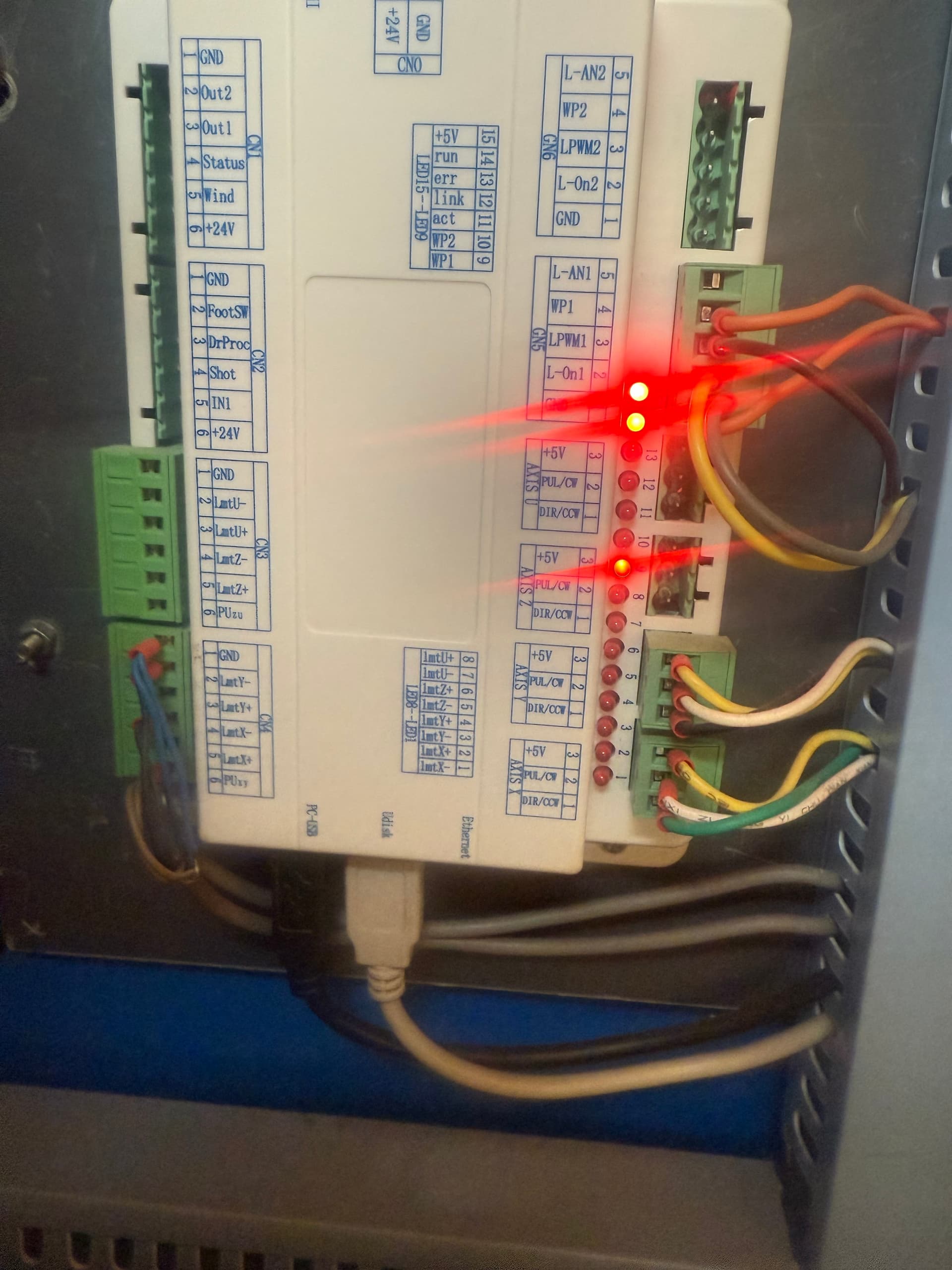

So USB connoted (to my laptop. i.e. not thumb drive) jobs stop a few MM Short and locks up the controller.
Using Internet job finishes and goes home and waits for next job,
The only thing I can figure is it uses a different driver, you have to CGF for your controller. So it must be a bug in the USB driver.

I make it out as a 6442 and have never understood why the labels must be on hidden surfaces:
Everything else confirms the machine is set up correctly and all the pieces seem functional, which is sometimes a completely unwarranted assumption. Thanks for the check!
My guess: they saved a buck by eliminating an Ethernet jumper cable.

Possibly, but more likely it’s noise in the USB connection, which is why we always recommend using Ethernet for Ruida controllers.
If you plug it into a LAN, ensure the router cannot assign the same IP address to another device using DHCP. The method varies according to the router, but this can cause baffling problems later on.

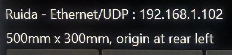

The Ruida config photo suggests there’s now a mismatch:
Make sure LightBurn’s device origin matches the corner where the machine homes.
Happy lasing!
so I had to set the organ to top left of LB workspace and standing looking at the laser it homes to the rear and left. The Size setting came from the machine settings so I matched it. Why do you say it is a mismatch?
Because:
  • The photo of the Device Settings shows the machine origin is set to “rear left”
  • You had said "workspce is set to top right,
  • laser is set to “Absolute Coords” top right
If you’ve since corrected the last two to match the actual machine hardware in the first, you’re set!
In Absolute Coordinates mode, the LightBurn workspace will have a small red square and a small green square that should both be in the top left corner to match your machine’s home position. If not, something is amiss.
