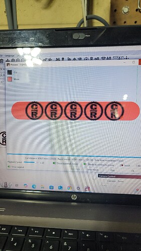

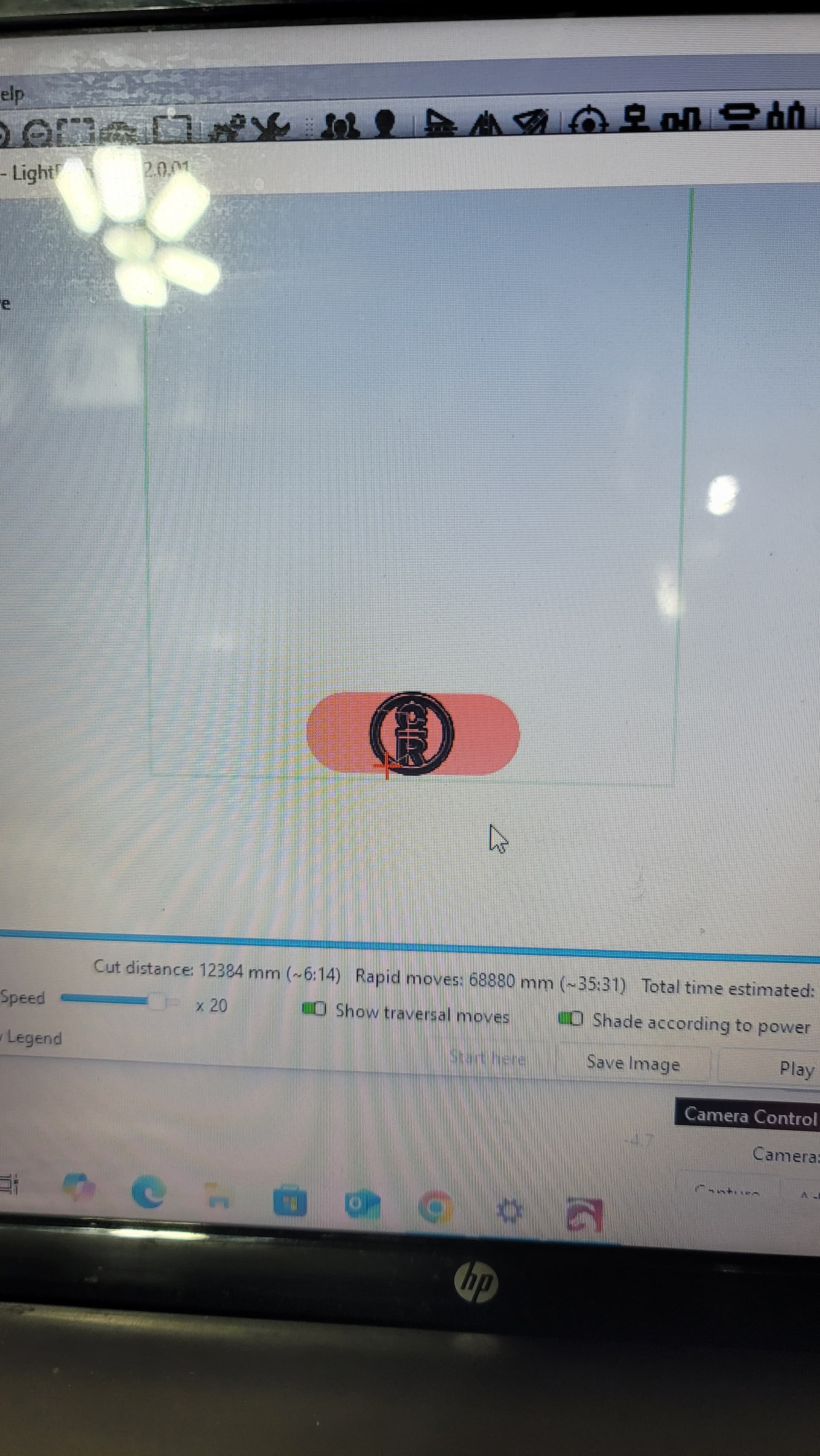

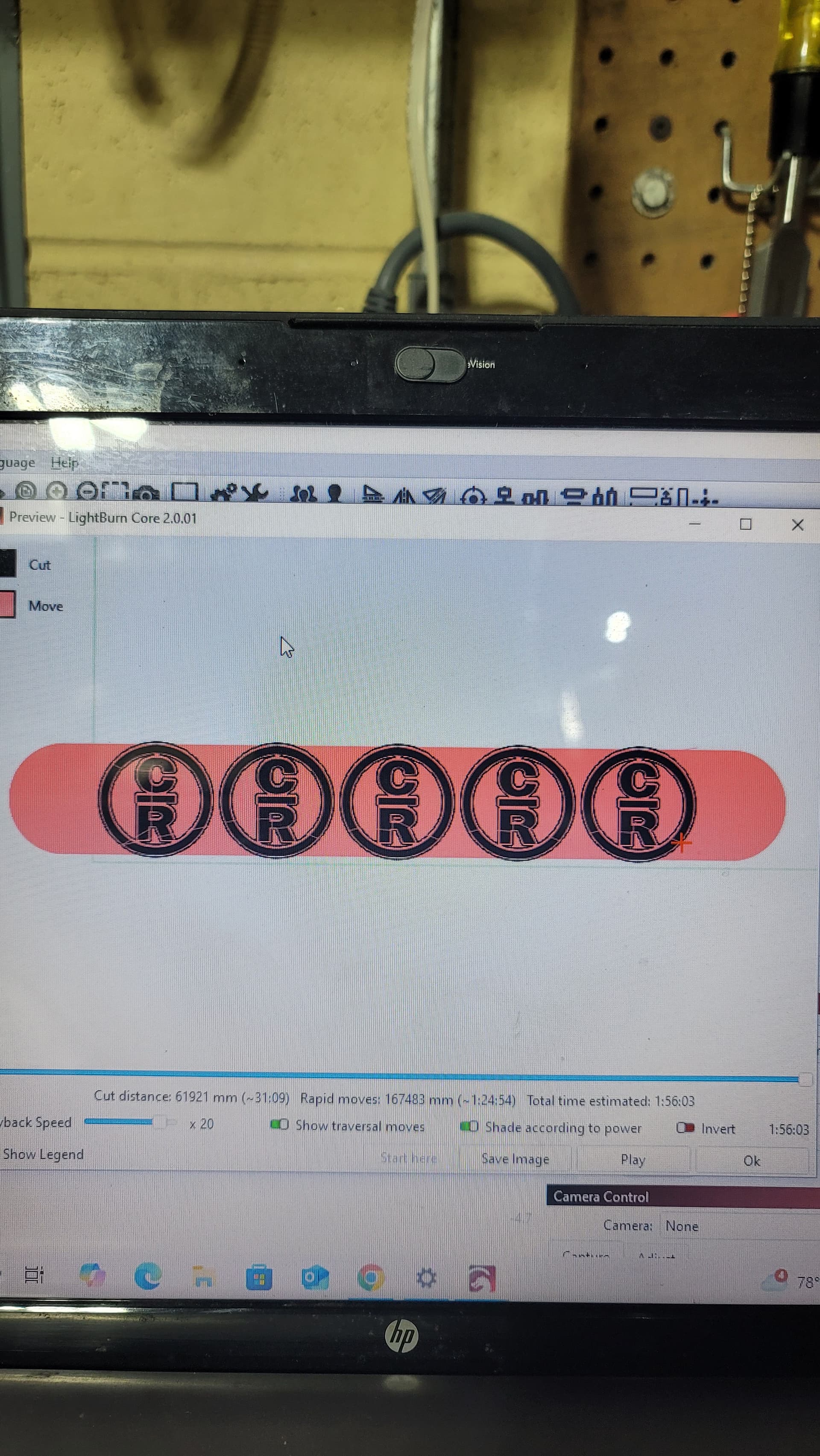

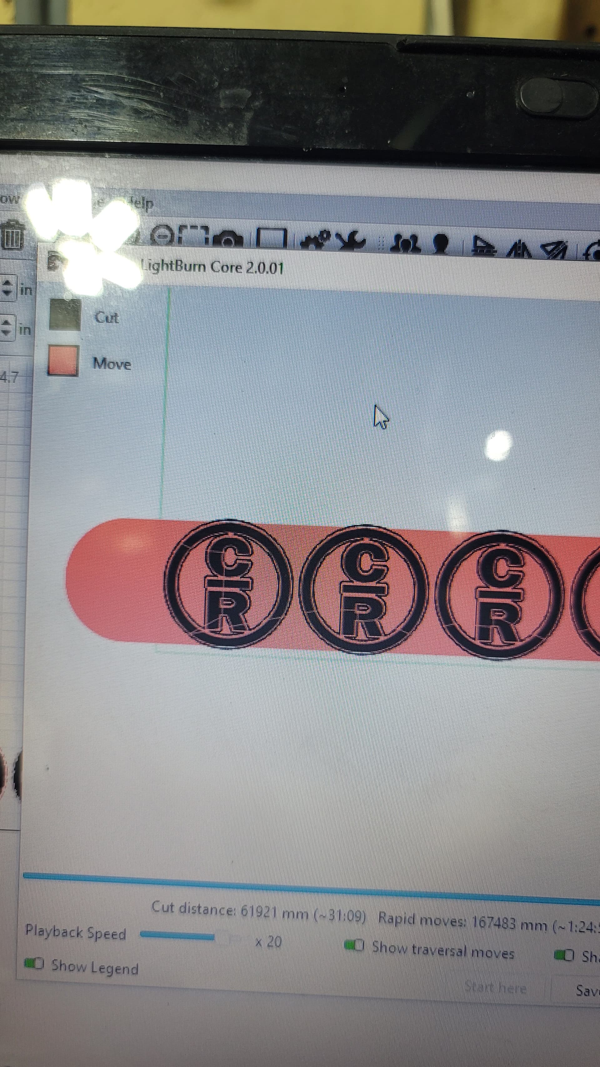

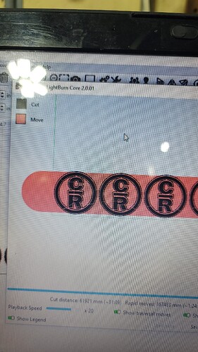

Now, the direction pad sends in reverse order (forward on x,y goes backward. I can run a job if I set the origin position to the top right corner and user origin (opposite of where it actually is). But when I send, it tells me the cut will be out of bounds, but its not, it just sends everything backwards. I have jobs I need to get done, so I started a job anyway and now the travel of the machine is going all the way to the edge for no reason and still tripping switches. I’ll add pics so you can see the preview. Any help is appreciated.
