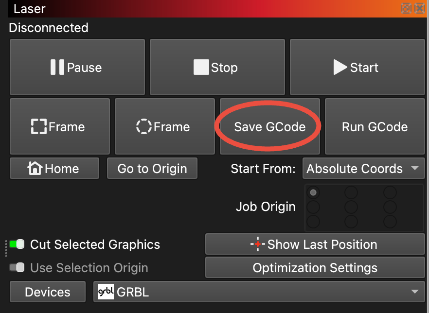

Since installing the latest update of Lightburn on my Neje 3, every time I send a file, the laser lights up and moves like it is engraving and/or cutting, but nothing is happening other than the blue laser showing on the material.I have adjusted the speed and power to no avail. I have even gone into the machine drop down and tried different in/mm/sec or min settings and nothing helps. I am using Version 2.1.03. Note: I have had this laser and Lightburn for about 2 years without any issues.
  1. Load a backup copy of the .lbprefs file that is dated before the upgrade.
  2. Confirm you did not get caught by the infamous “Linking” switch.
The method of managing the Design and Control units has changed.
@BillPiper I’ve merged your conversations into this topic just to keep them together.
If you are still having issues, try cutting just a simple square shape, and use the “Save GCode” button and attach that gcode file here.
