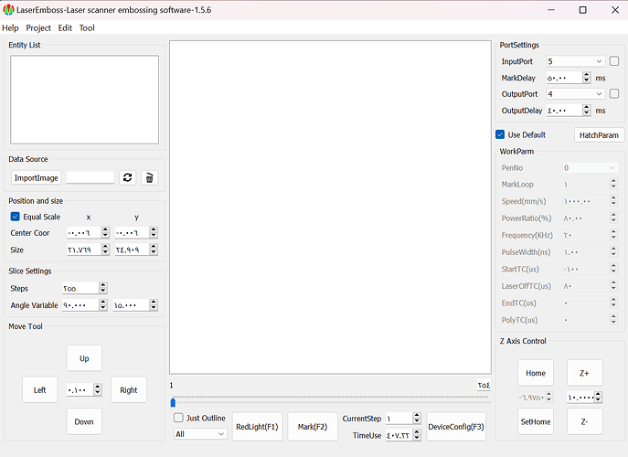

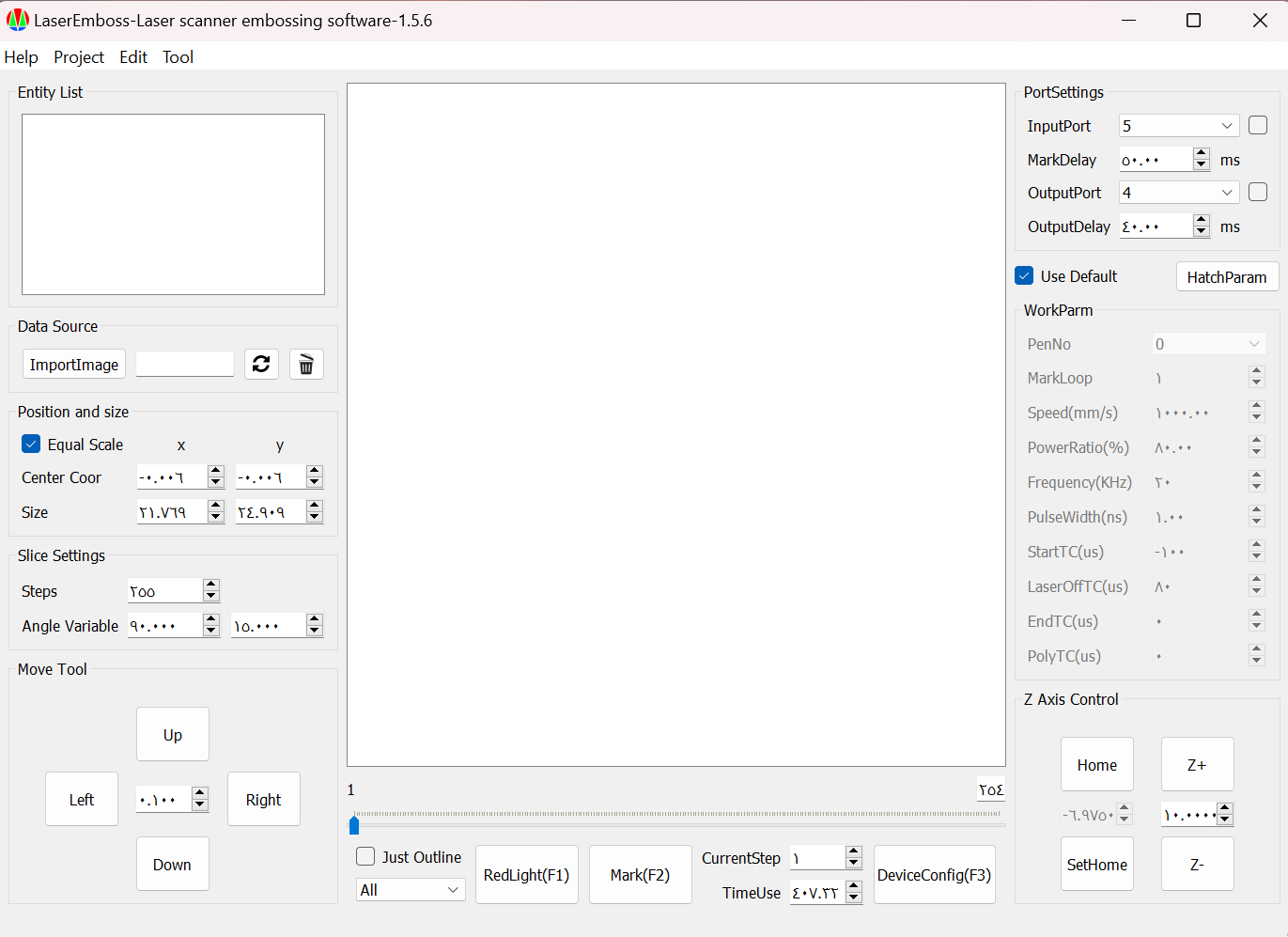

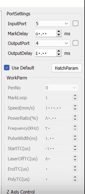

But I want to switch to LightBurn, how do I copy all the settings to lightburn and are there better settings for engraving agate stones with deep and high quality text?
You can see the settings in the program, the reason I want to switch is because LaserEmboss slices the image and makes it with lines and unreadable text when engraved, while I saw that lightburn gives best quality

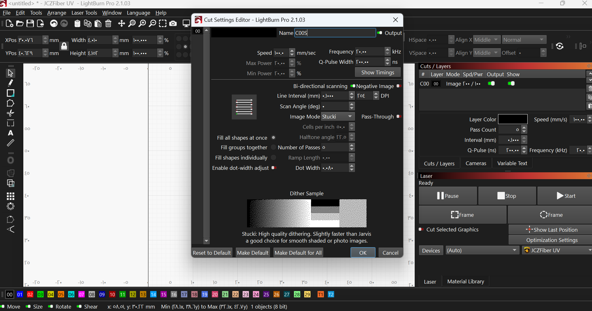

I can’t read your number values of the cut parameters in both screenshots.
You’ll need to manually transfer your cut parameters (Frequency, Q-Pulse, Speed, number of passes…) from LaserEmboss
to LightBurn:

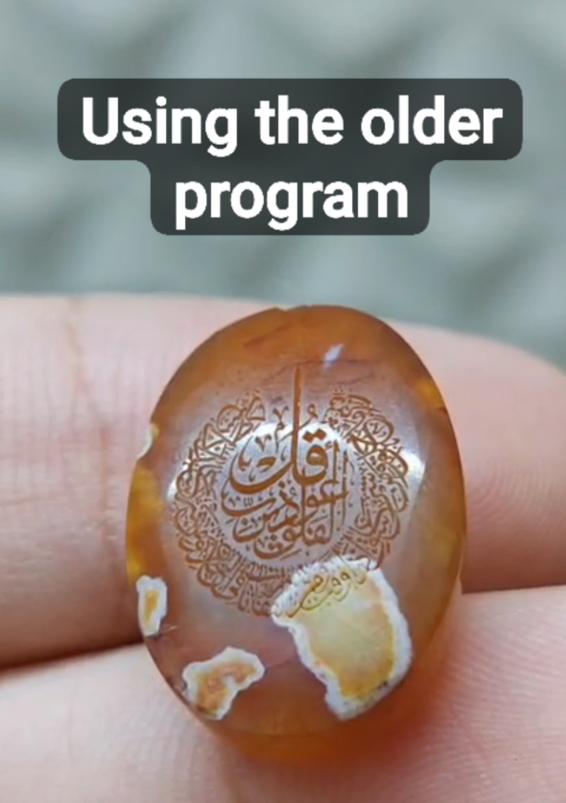

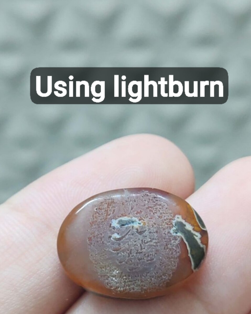

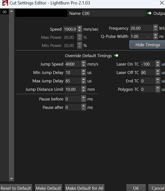

I copied all the settings from laseremboss to lightburn but when I start it, even after 50 passes it gives shallow white marks on the stone with no engrave or details
Here’s the difference and the text quality with deep carving I need vs what’s happening currently, I’m sure I’m doing something wrong but I’m new to this so bare with me please

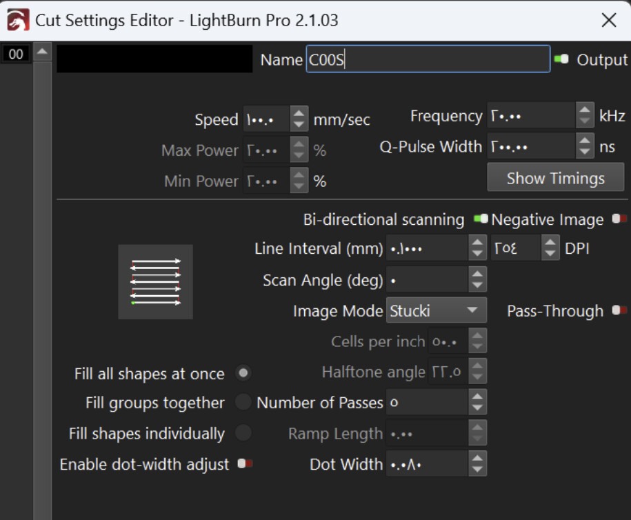

What line interval did you set in LightBurn?
To me, it looks like you are using too large an interval.
I tested these pulse width, frequency, and speed settings using a 0.01 mm interval.
I achieved beautiful engraving on agate.
We can’t see the Line Interval or the mode you are using here (Image, Line / Fill) because the Timings are being displayed.
Can you share your .LBRN2 project file?
