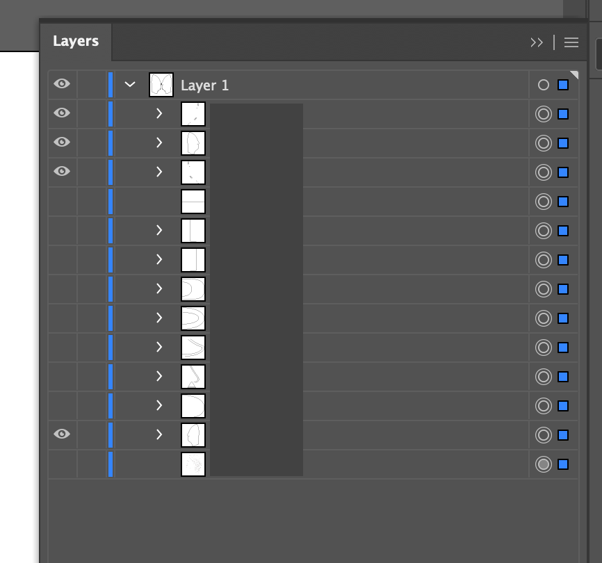

To clarify, this is what my layers look like in Illustrator, so maybe its ignoring the sub sections of layers now? As I said the older version respected all this I notice there is a checkbox to import hidden layers from AI in this version but maybe that applies to an entirely new layer and not the sub layers?
Thanks!
After some digging around, it seems its respecting master layers, but not items inside those layers, so I would need to move all the items I want to hide to a new layer and the preference item to add hidden layers works.
But can you please roll back the functionality to where it also respects sub layers within those layers please?
