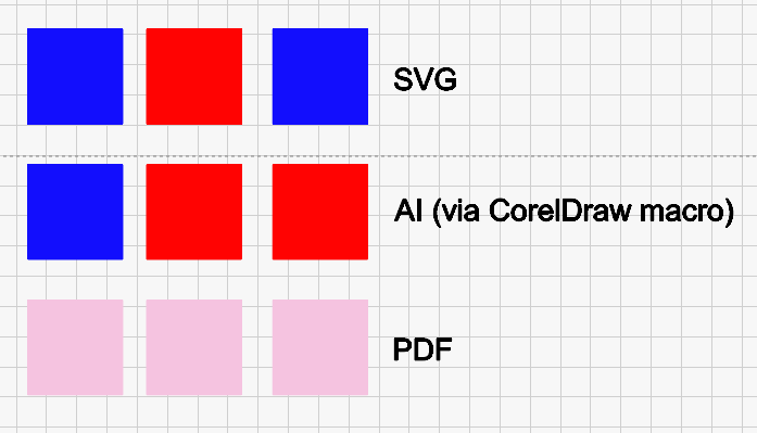

Ok, I’m back now! Out of interest I thought I’d do another test with pdf. This is how the same Corel file exported as pdf renders when imported into LB along with the other two previous tests:
So… three different results depending on whether you use svg, ai or pdf! I can’t imagine that this is the intended behaviour or whether there’s some technical reason for the differences.
I suspect the PDF and AI results should be the same. Possibly an issue in the PDF generation?

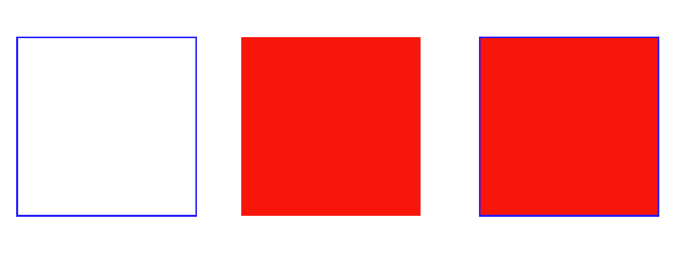

I did consider that but ihe PDF looks correct in Acrobat Reader:

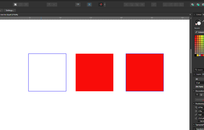

Affinity Publisher:

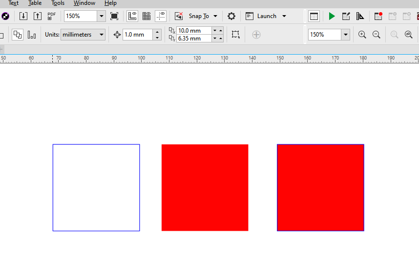

CorelDraw 2018:

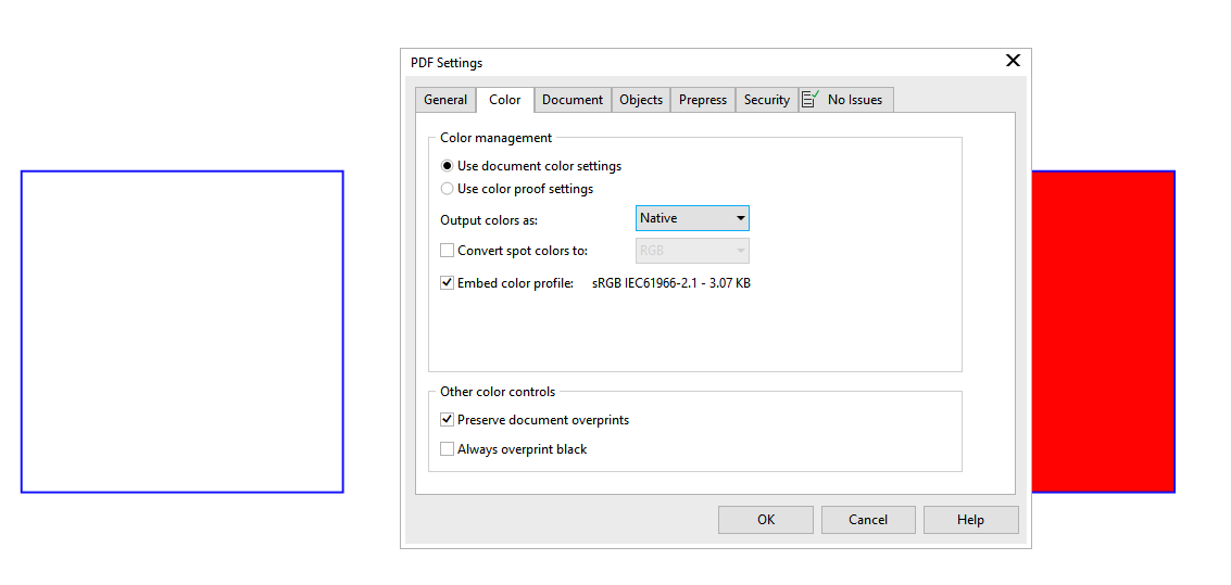

@Marcus_Wakefield PDF contained spot colors. The PDF that @berainlb created from Inkscape removes the spot colors and converts them to CMYK.

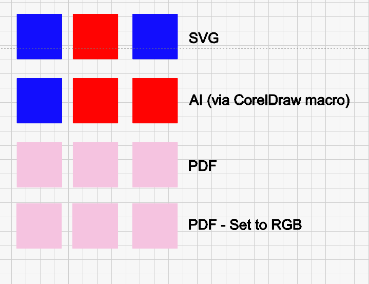

That’s interesting. I used the LightBurn colour palette to specify outline and fill colours so I thought it would export as such. Here’s the PDF export dialogue:
This has ‘Native’ (whatever that means). I’ve exported again but this time I changed that drop-down to RGB and I get exactly the same result in LB:
