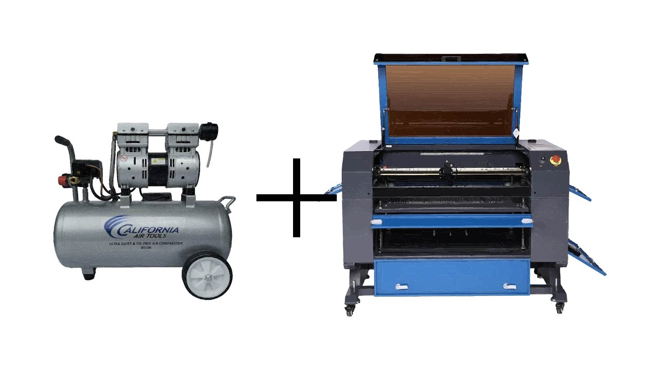

Watch some YouTube video’s and see if you’re up for the upgrade. Here’s 1 option.
