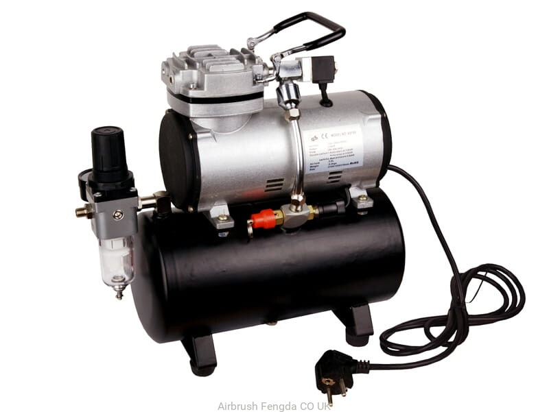

As for Air adjusting the Pressure, a simple small and quiet airbrush compressor with a small tank to stop air pulsing! will come with a pressure regulator, can pick up on E-bay for about £50 2nd hand.
It will probably runn nearly continiously, put a PC fan above the head, to keep it cool, works a treat and pretty quiet for the money
Unfortunately to provide the amount of air needed for cutting these little guys don’t do it. Pancake compressor is next step up.
Agreed that the small compressor, is on the limit but tbh I Have used one for some years, yes it runs continiously, with the fan on it it does stay cool, I ran it at 10Psi at the flow rate of 20ltr’s per minute, I did through the constant noise although only 60db upgrade to a larger unit with 25 ltr tank that delivered 100psi at 140lpm, but even now i do not go abouve 25 psi cutting 10mm plywood, i dont think that cutting thin materials needs a massive ammount of air, on a diode laser, the other thing that steered me away from the pancake style units was they are NOT oilless and have a very limited duty cycle, and the output of the lower cost units is not much greater that the little guy, as mainly used as low volume low duty cycle dental type compressors,
As for cutting acrylic, i never use air just makes for a nasty edge with a diode,just a trikkle to keep the disgusting lens destroying vapours of the lens, same with etching just to keep the path clean and the lens clean, but yes bigger is better, depends on the budget available, pankakes are quieter but a decent unit comparabe to a twin head oiless compresser is x 4 and of course if you have a large area it could be running for hours unless it is capable of running air tools with a large resevour.
