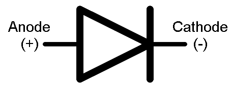

A quick guide to diodes…
Electron flow is from the cathode (banded end of device) to the anode. If you ground the cathode and put B+ on the anode it will turn on and conduct… with enough current your diode will fail…
With a snubber, you install the diode with the arrow (cathode) pointed towards 24V…
When the field collapses, just like in a transformer, it will induce a pulse of very low current of the reverse polarity, and the diode will turn on… this shorts out the spike…
I use a very common small signal diode, the 1N914… you can get them at Amazon… more than you’ll ever need or want…
You can put them at the Ruida if you wish… from 24V (cathode) to the sink (anode) signal…
Their is virtually no current involved, but if you don’t drain it, the minor amount of current becomes voltage… it can reach a few hundred volts if not dealt with.
