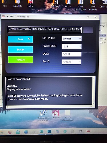

hello, I have a problem with air assist, when I turn on the laser, the air pump runs and cannot be turned off. even if I turn it off in the program during engraving, air assist still works, it does not respond to my commands at all, I have it set to M8 in light burn Thanks for help
If you send M9 via console, does the pump turn off?
not always running
Does the blue LED next to the air assist connector on the mainboard is always on?
how do I find out if control via the console works?
yes it’s still blue
If you send M8, the pump turns on, if you send M9, the pump turns off.
Then the output is not toggled. Try flashing the firmware again:
ok i will try it
which of those options should I download?
I tried to reinstall the firmware, but the air assist still does not work, the blue light is still on :frowning:
