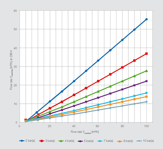

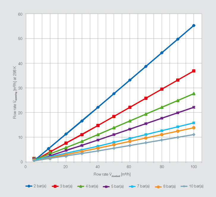

I’m leaving some images and a link to the page I consulted when addressing the issue of air assist in my laser machine.
Air nozzle tech data

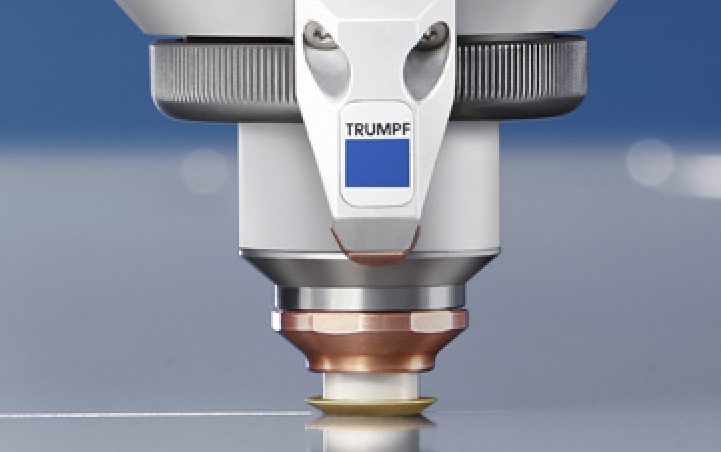

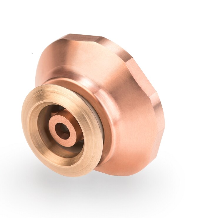

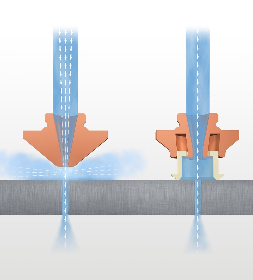

Found this here, very interesting: Trumpf has developed a special nozzle which sits on the material to increase the air flow INTO the gap.
They say that with the same power you can cut 12mm instead of 10mm steel.
The nozzle itself is movable and follows z misaligments. Looks a bit risky if small parts get in the way…judge yourself. But this is proof that the cutting depth (and with wood the charring quality) increases significantly (or you can lower the power and increase life expectancy…or cut faster)
If you look at the nozzle design, the air pressure is pushing down the nozzle, no spring. I think this can be done with the part weight or a spring a bit easier.
I would even design a kind of hovercraft levitating so that the air stream is pushing down the material.
Funny, I thought about the same design for an ultimative nozzle. I’m just not shure wether this creates a lot of crashes and step losses which would be fatal.

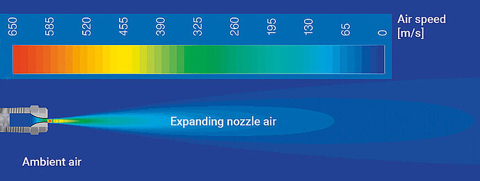

Also, be aware of the air channel itself: it’s not a long tube but a cone which increases the velocity at the tip. I don’t see that they are calming the turbulences with some fancy laminar stream devices.

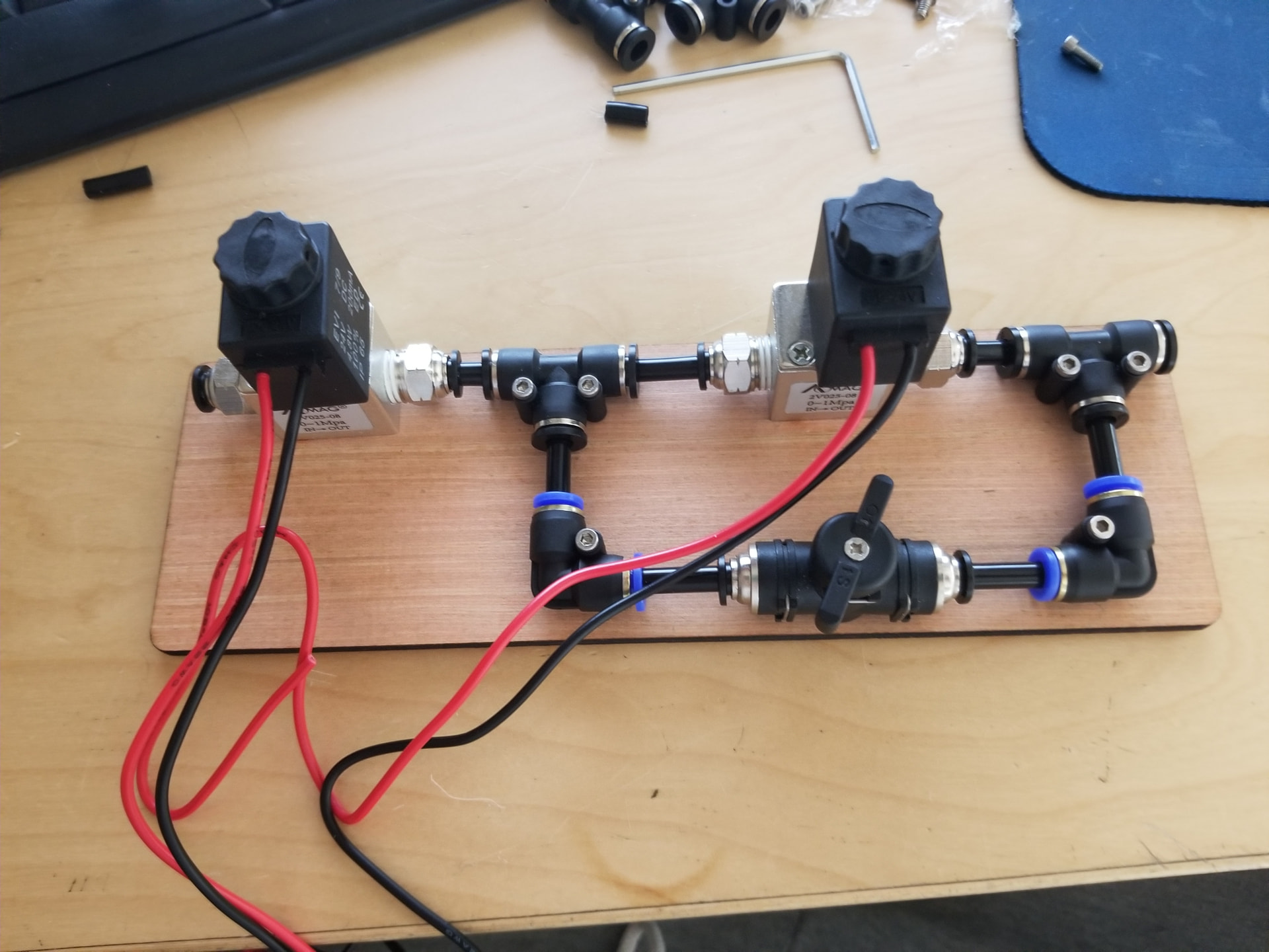

Many of the larger machines that have a Ruida or similar dsp type have some way to allow low pressure and high pressure system.
One of the reasons the Trumpf nozzle helps is that it maintains pressure on where the cut it. Most of the time when cutting things like steel, the oxygen feed through the systems helps a lot with the cut, whereas with most hobby size lasers this doesn’t happen with wood as well. With metal, you usually don’t have to worry about what the finish looks like. That nozzle would likely scratch wood or acrylic.
Some of these for metal, have some type of sensor to maintain the Z setting. I don’t know how much 12mm steel warps, but I would think not much.

You want snub diodes across any coil that becomes energized. Although some ss switches have them internally.
Don’t know what the diode in @ednisley sketch is used for unless his controller produces different signals for running and high pressure. On mine the status is always low if the machine is operating. The diode would turn on both switches if Air goes low. On mine, it’s called Wind, but it can only be active when it’s operating, so there is no need for a diode there.

I learned that the Ruida has two differend switches, but WHY low air assist at all?
The way these work, without air assist the lens is exposed to the debris from the surface. Mine is configured to always use a very low pressure when running, so I use the Status output (or sink) and when I need higher pressure I click the air assist on the layer. When this layer executes, both Status and Wind go low.
I use a dual solenoid setup. Status lets high pressure air into the system using the left solenoid. It’s blocked by the second solenoid (right) and passes through a reducer (bottom) to lower the air pressure. When air assist is selected, Wind becomes active and the second solenoid opens and lets whatever pressure coming into the system pass through to the head.

It’s wired-OR logic to turn the pump on when either STATUS or AIR goes active, with the AIR output also activating the high-flow valve.
So the pump runs whenever the laser controller is busy doing something or when I poke the controller’s Air button, with high flow whenever the LightBurn Air switch is On for that layer.
St. Sadler did it with relay logic, but a diode has the same effect.
I understand what it does, with my controller it isn’t needed as Status goes low anytime I’m executing a layer. It must be executing a layer, so Status should be active. Doesn’t yours work that way?
So the only place I use small signal diodes is across the coils for a snub effect.
:grinning_cat:
True, whereupon the AIR output controls the high-flow solenoid as directed by the LightBurn Air switch.
Those two outputs can’t be directly wired together, because then the AIR output wouldn’t have the separate effect needed to control the flow rate depending on the LightBurn Air layer switch: the high flow valve would always be active.
Also, without the diode, poking the controller’s Air button when it’s not running a job wouldn’t turn on the pump. Admittedly, I don’t do that very often, but it’s nice to always have the button work the way it should.
