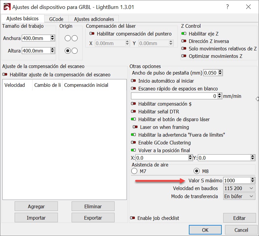

When working with the laser and the program the transverse/displacement lines appear in the final work
If I change the values of Laser mode enable ($32) from 0 to 1 they disappear but the power of the laser decreases and the marks are removed.
However the power of the laser is not sufficient and the engraving or cutting work does not take place.
What other option or configuration could be made to make these lines disappear and continue working please?

$32=1 for your laser. The reduction in power can have several causes.
The most common cause of this is when the requested Engrave speed is too high.
Please provide the Speed and the Units of the Speed you are applying, like 400 mm/minute or 6000 mm/s. The units do matter.
Another cause of unexpected low power is the S-Value Max not being equal to the setting for $30.
Please open the Console window and request the settings report by typing:
Then press enter.
Please copy and paste that report into a reply here.
If you have already found the $32 setting the $30 is very close.
You can also capture your Device Settings with a screen capture tool and share the image by dragging and dropping the image into a reply here.
