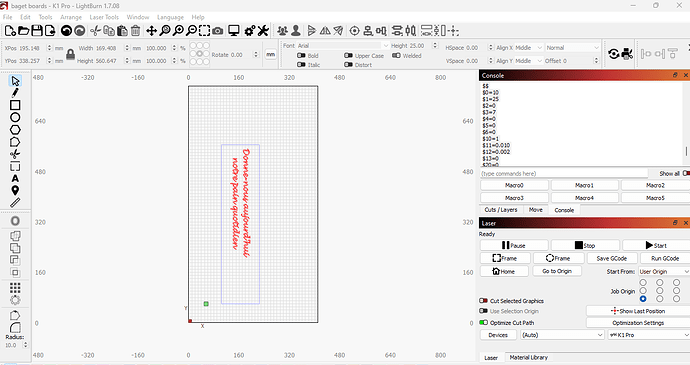

I’m fairly new to the laser game, and have only had this Ikier K1 Pro for about 2 yrs with limited use. After upgrading to the extended version, I am consistently getting an alarm 1/hard link trigger error. I check and rechecked the wiring, no luck. My work piece isn’t anywhere near the edges. So I’m thinking maybe there is something miscommunication with someone else? Code wise? Again novice, so tell me what else I can share to help get me out of this mess please!
Did you update Lightburn to the machine size when you installed the extension? Enter $$ into the console and copy / paste the output here. Also post a screenshot of your entire Lightburn screen with your project loaded. No phone pic please.

Sorry, I should have clarified. I have used the machine successfully following the addition on the extensions.
‘$$ enter’ =

$130=410.000
$131=410.000

Your machine is still set as a 410 x 410 size. In the console window enter $131= whatever your me was Y dimension is.
updated. still receiving error. Any other ideas? Really appreciate the swift responses and feedback
Your using user origin. In the move window, click go to origin and make sure the point you set on the machine is close to where it coincides in Lightburn or switch to Absolute Coordinates (my preference)
