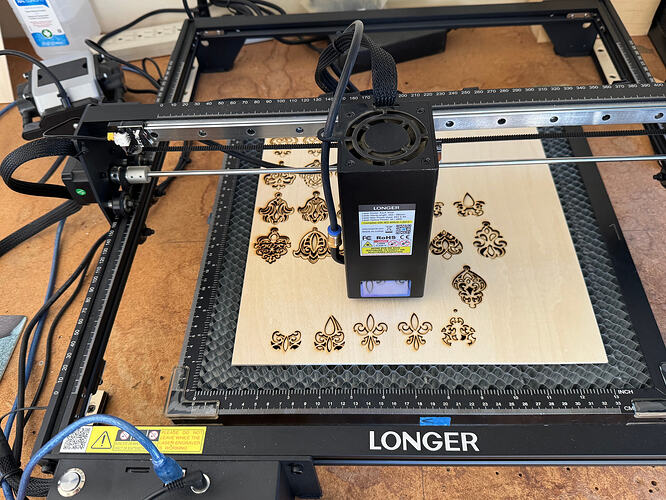

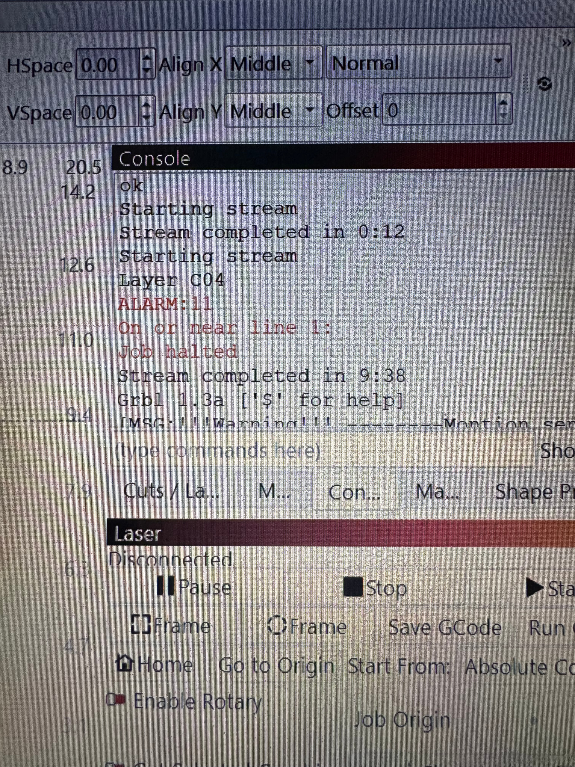

I’m having difficulty with a burn that I have completed before with no issues. I am now encountering an:
Alarm:11 on or near line 1: Job halted
and I’m not sure how to proceed. My current burner is the Longer Ray 5 40W, Core 2.0.05 (had to roll back from the latest editions as started running into errors with the Svalue). Connected to an HP 17-cn3 via usb cable.
This code has come up before when I attempted a separate burn that I had to break individual pieces out and burn as single items, but this current burn has been completed several times before with no issues.
Any ideas or guidance on how to proceed would be greatly appreciated.
The highest ALARM number I can find is “10”. Alaem 11 does not appear on anybody’s list.
This means you will have to contact the manufacturer directly because it is specific to their controller.
Are you loading the GCode to the controller, then running from there (instead of using the Lightburn Run button)? If so, you may have a full memory issue.
A few things to try:
Home the machine and test.
Remove and reinsert the SD-Card and test.
Check USB links and plugs.
Type ? into Console Window and check for any letter(X Y or Z) after the PN.
