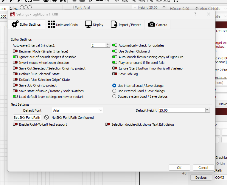

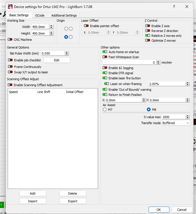

Laser is not working every time I hit frame. It gives me the alarm to telling me on or near line 0 job halted. I’m not sure what happened. I was using it a while back in rotary mode, and I disconnected all the rotary stuff months ago and for some reason, settings got screwed up and nothing is working again. Need help to try and fix this solution home properly But will not do frame for any reason and it is in start form absolute coordinates please help.
Need more information to be able to help. Please post a screenshot (not a cell phone pic) of your entire Lightburn screen with your project loaded and the Cuts/Layers Panel and Laser Panel visible. Also post a screenshot of the Settings Window (Gears icon) with the Units and Grids tab visible and post a screenshot of the Device Settings Window (Wrench and Screwdriver icon).
I don’t see any issue with these other than I would probably turn off hard limits unless you have switches at all 4 corners.

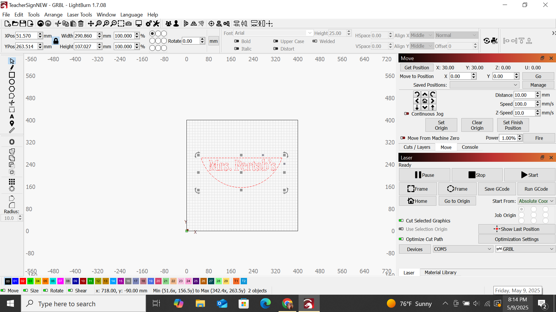

Does the homing process work correctly? Left front corner?
Do the arrow keys in the move window move the laser in the correct direction?
Home the laser then in the console window type $# then enter key. Type $$ then enter key. Copy and paste all the contents of the console here.
That first image looks strange.
  1. Is it possible you have something outside the work area and we cannot see the selection squares around it?
  2. Is it possible you drew that circle afterwards and it is not the original design that caused the error?
Mike
Is that Middle Right side short line an indication of something.
If you are talking about Joe’s drawing, I do not see that line. I was going by his circle being dashed lines with no visible “select” markers around it.
