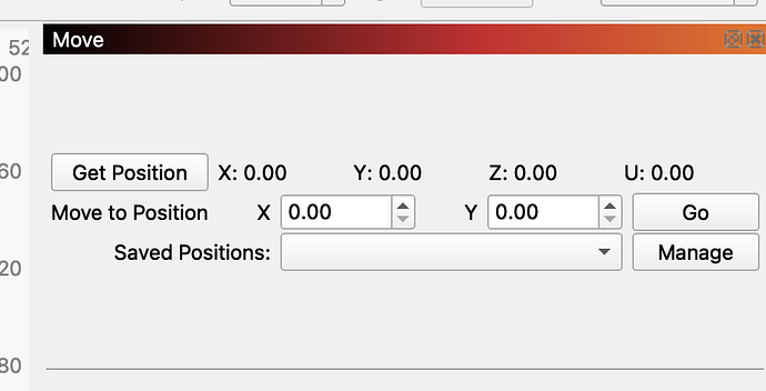

Since we can’t see what you’re seeing on screen; In the Lightburn Move Panel go to X0, Y0
then in the laser panel click show last position. With the laser panel open take a screenshot of your entire Lightburn screen with your project loaded. (no phone pics, please)
If you are asking to perform these steps when the ALRM:13 occurs, that isn’t possible because the laser goes into error mode and becomes unresponsive. A hard reboot of the laser is required.
