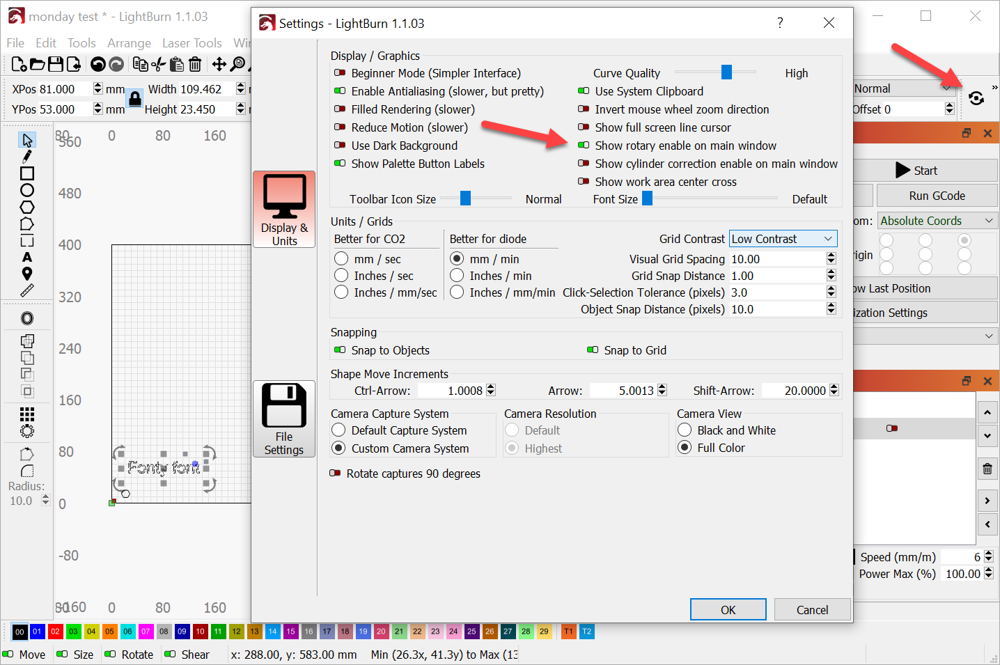

The Rotary Setup tool is in Laser Tools.
It’s important to switch the Enable Rotary option off in this menu when finished with the rotary device. This may address Alarm 3 quite handily here.

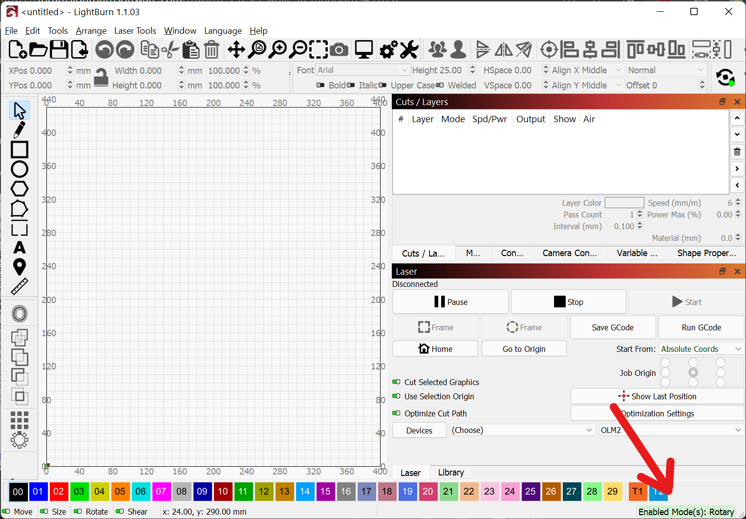

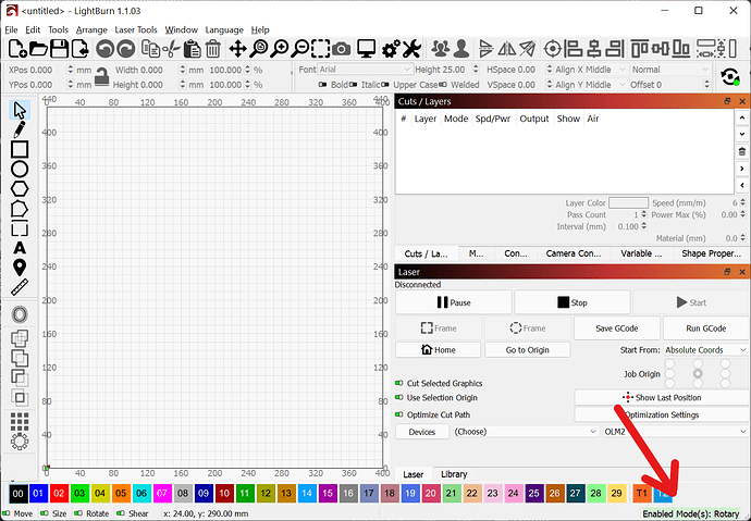

Rotary mode doesn’t seem to be on based on one of the screenshots. I would have expected a rotary mode enabled indicator on the lower right.
Top right for me. And that sly rotary setting can shut the indicator off without shutting the rotary off.
I was referring to this:
You are right. I overlooked the text indication.
