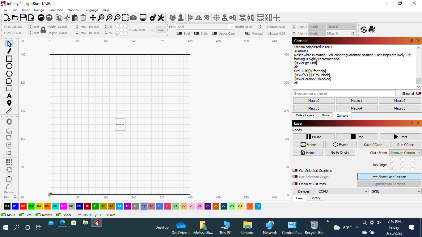

If I run the laser it works perfectly but if I frame or use the move buttons the laser freezes and coordinates do not match. Thanks for the suggestions.
Can you take a screenshot of the coordinates not matching and the exact error message generated?
When I power on the laser is at X0 Y0. If I frame a project the laser goes to starting coordinate and freezes. This is the error created.
ok
Starting stream
Stream completed in 0:00
ALARM:3
Reset while in motion. Grbl cannot guarantee position. Lost steps are likely. Re-homing is highly recommended.
Grbl 1.1f [’$’ for help]
[MSG:’$H’|’$X’ to unlock]
[MSG:Caution: Unlocked]
ok
Then if I move laser back to X0 Y0 - get posistion it reads X=109.13 Y=12.2 Z=0 U=0
Place job in center of workbed and laser remins at X0 Y0 but lightburn shows laser as center.

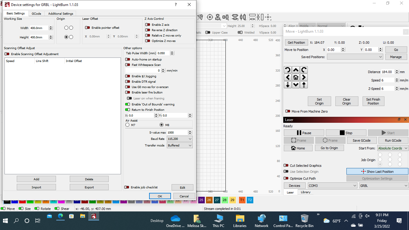

Can you take screenshots of your Move window and Device Settings window?
I think for some reason your stepper is losing steps.
I don’t see anything too unusual here. Do you hear any odd noises when you try framing? Do you hear the motors struggling or buzzing when you try framing? It seems like somehow the controller is out of step with the steppers but nothing seems off to me.
One question, was your speed setting in Move window always 6 mm/m? Are your jogging moves extremely slow?
Just to confirm, you have absolutely no issues when running any job? It’s literally only during framing and moving that you see this issue?

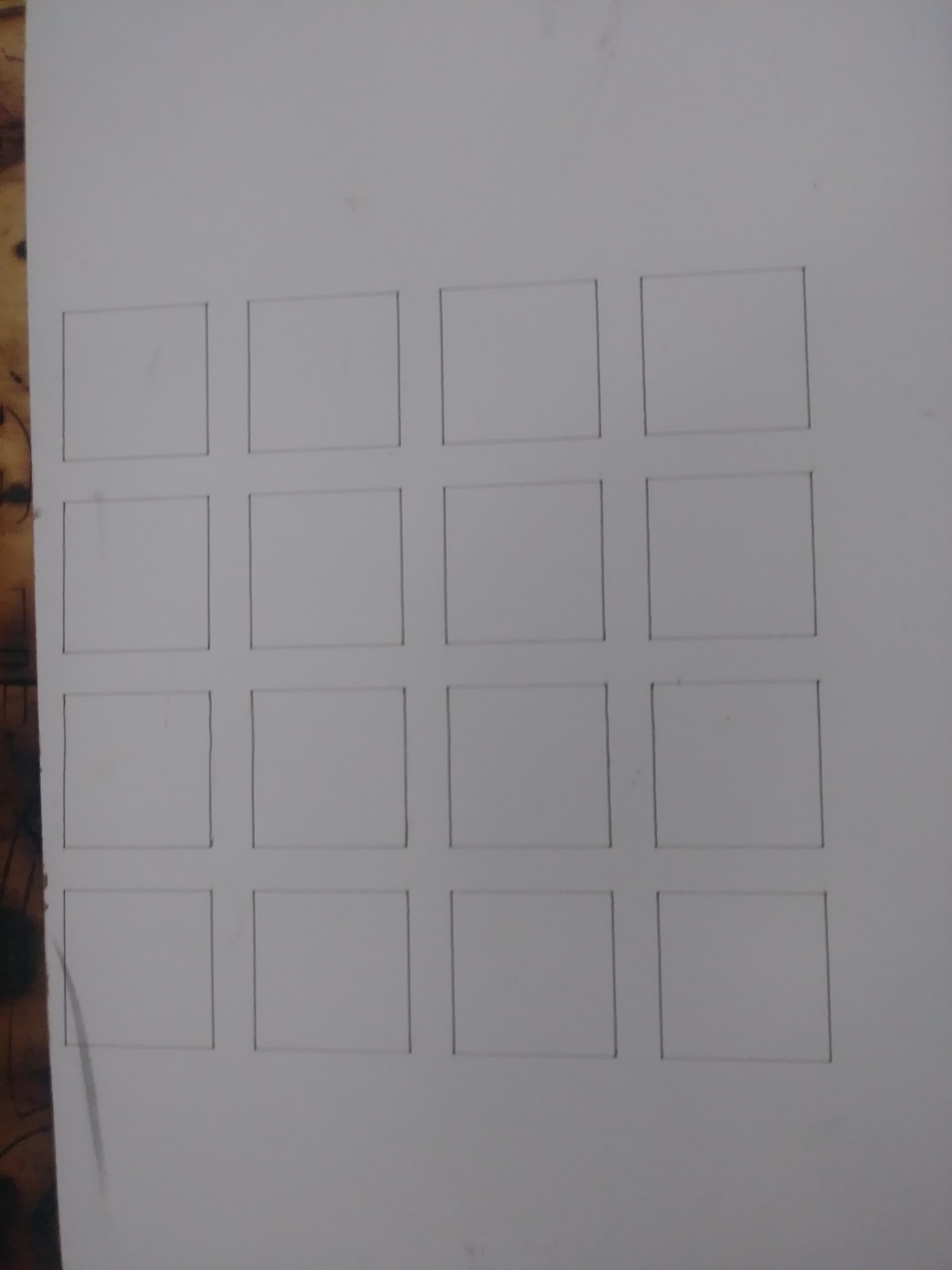

If so, can you run a grid of evenly space squares? Want to make sure you don’t have any issues, particularly with the distance between squares potentially changing. Also, want to see if your coordinates lose track when running a regular job.
The link I posted has this to say about that error
I wonder how grbl would know it has lost steps…?
GRBL is indicating that it cannot guarantee steps and so likely lost. Not that it actually knows that steps were lost. It cannot account for lost steps but also cannot account for all steps, so assuming worst case.
@mizfitcycle Try swapping out the USB cable and/or switch USB ports. It’s possible this is an electrical issue but would be odd if it only affected framing and move operations but not regular jobs.
Thanks for your help troubleshooting. I think I am just going to frame my work using low power to ensure correct placement. Here are the squares, job runs fine but I do have to power down and reset after each pass. Which is fine. I do appreciate you looking into this. I should be fine moving forward, I will bypass the framing.
