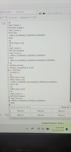

Ok so I am a bit confused… I have an xtool d1 pro laser that i converted for tumbler use only. I keep getting this alarm:51 tilt check. Not all the time, in fact I have ran 4 tumblers and haven’t had any issues. Sometimes if I frame 3 times, on the third frame, i get this issue. Now I get this issue every time I try to frame my project. Ive played with wires, turned off the limit switches and everything else i can think of. I cannot seem to find any information on this alarm 51: tilt check anywhere online. Any ideas?

Ok so i think i figured it out by stupid luck. I decided to open up xcs(xtool software) and see if i had the same issues I had in lightburn. I did. They gave me an option to see more details. Xcs had said the laser moved so it stopped the project. I went under xcs laser settings and there was an option that was turned on to stop the project if the laser moves. I turned it off and now it is working fine.
