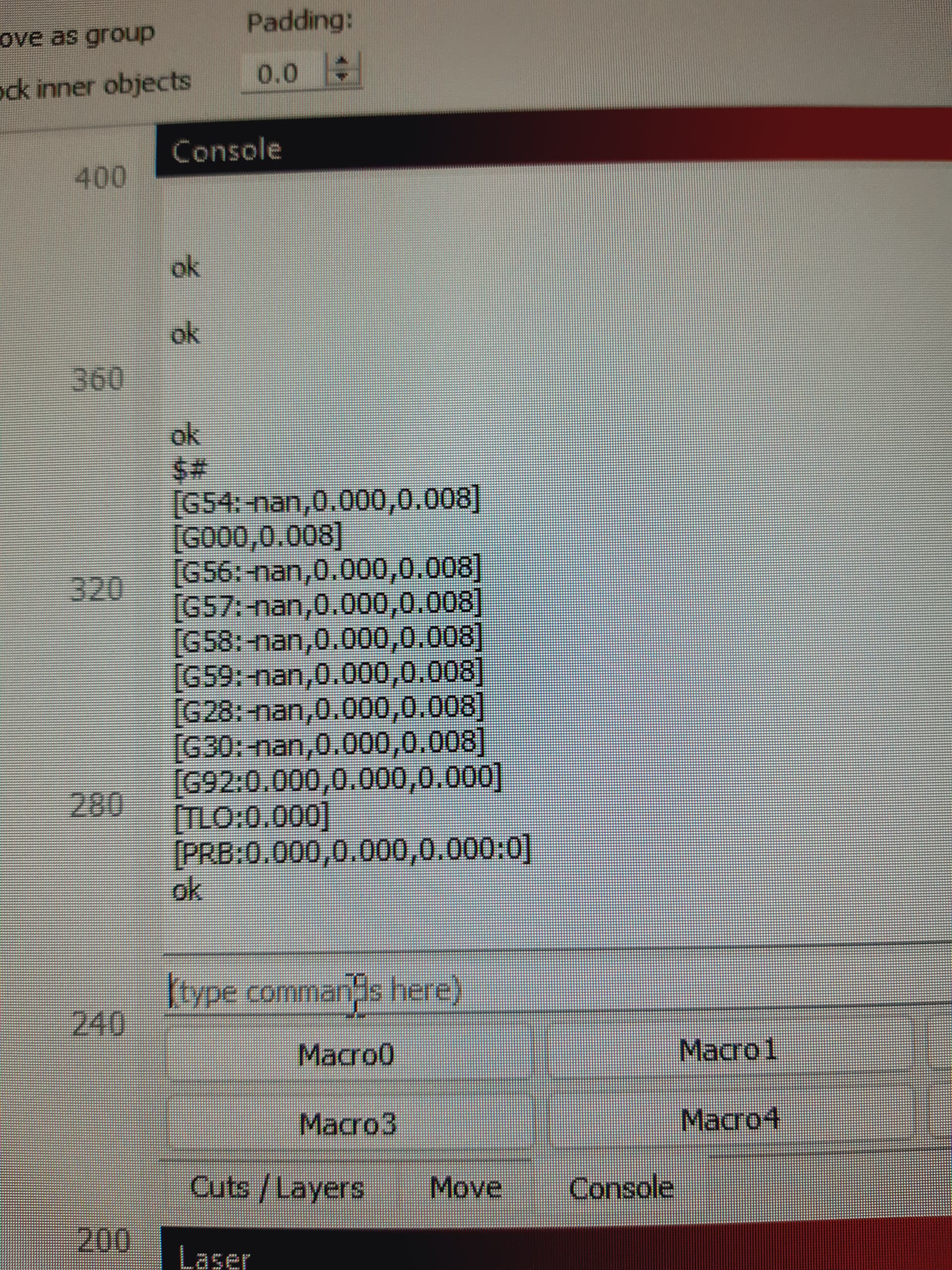

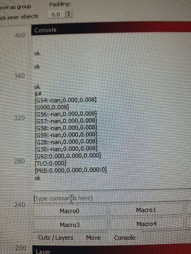

Alarm 8 and alarm 3
still doing -nan on $#?
Yes, still doing nan
try this
in console
$RST=*
press enter
The moment machine says “restoring defaults”
power it off, and power back on
recheck $#

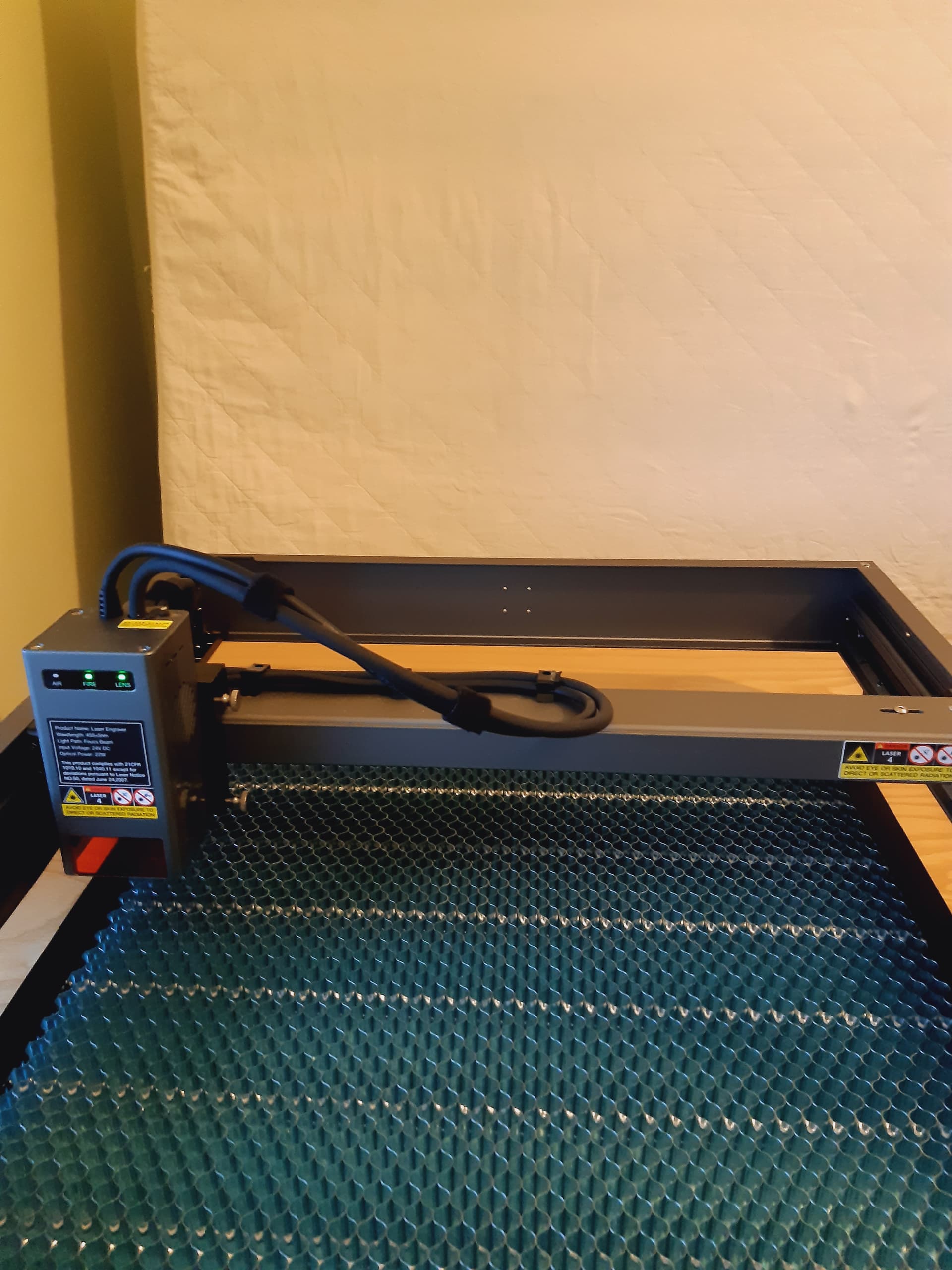

also did you get any chance to record the homing cycle?
(i do feel is time to reach for manufacutrer too)
The laser will now move to the left
But the bar with the laser on it will not move at all…
Did try to video it, but when loading keeps coming up you are not authorised to load this…
might need to upload it to na external service and then past link here
Say youtube or similar
