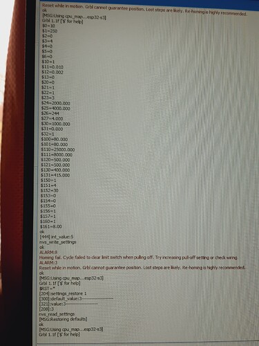

One other thing to check;
Type $# into the console and press enter.
If you see ‘-nan’ results in the offsets, that may indicate a firmware issue I have seen before with this model which is likely to cause positioning issues.
![1705506053392265811565725661481|375x500]
(upload://6fcCxR23Yypc80FviiYLtDOb0dB.jpeg)

Well I’m not entirely sure if the not-a-number error is the source of the problem or a result of the homing cycle not completing correctly, it does not seem to clear with a $RST=* or $RST=# or explicitly setting G54 with G10 L20 P1 X0 Y0 Z0, so I put it down to a firmware issue. Although thinking about it again now as I write this - if it’s a missing machine coordinate of course it would have trouble with all the calculated offsets. So could be worth disabling the homing cycle in GRBL and positioning the laser by hand, if the machine coordinates still do not initialize on power up then that is surely some sort of firmware problem?

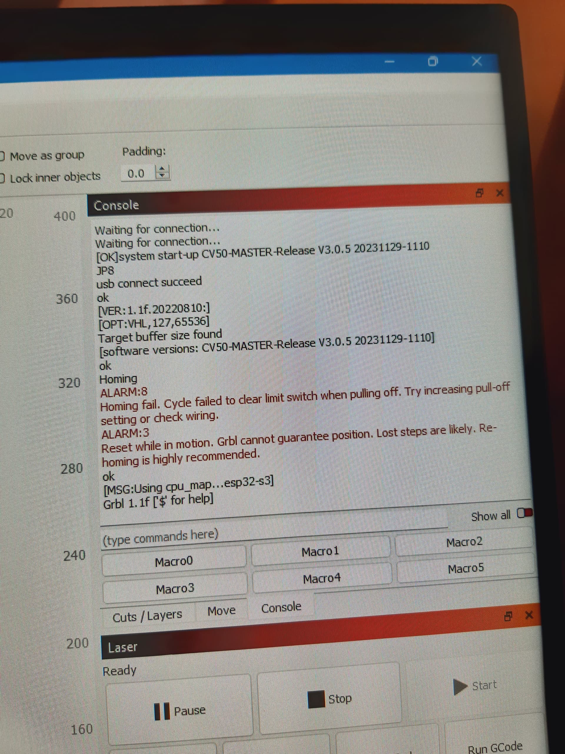

I notice too Taker firmware is very old 2.0.5
where latest, from Jan 5th is 3.0.5
Maybe is worth also updating?

Hi… problem still there, brand new dats cable, all firm ware updated and still nothing happens.
